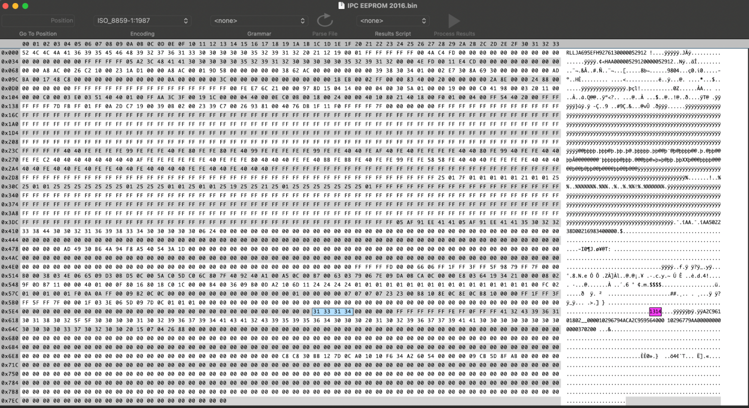

20 hours ago, pistnbroke said:
If its of any help to anyone, in my case the highlighted byte is what caused the mileage to still display dashes even after the VIN and PIN were successfully changed.
01 = Odometer Lock Status 'Active'  -  dashes are displayed on the bench or in the car.
00 = Odometer Lock Status 'Inactive'  -  last known mileage is displayed on the bench and correct current mileage read from the BCM is displayed in the car.
Here is the comment by pistnbroke that shows how to fix it.

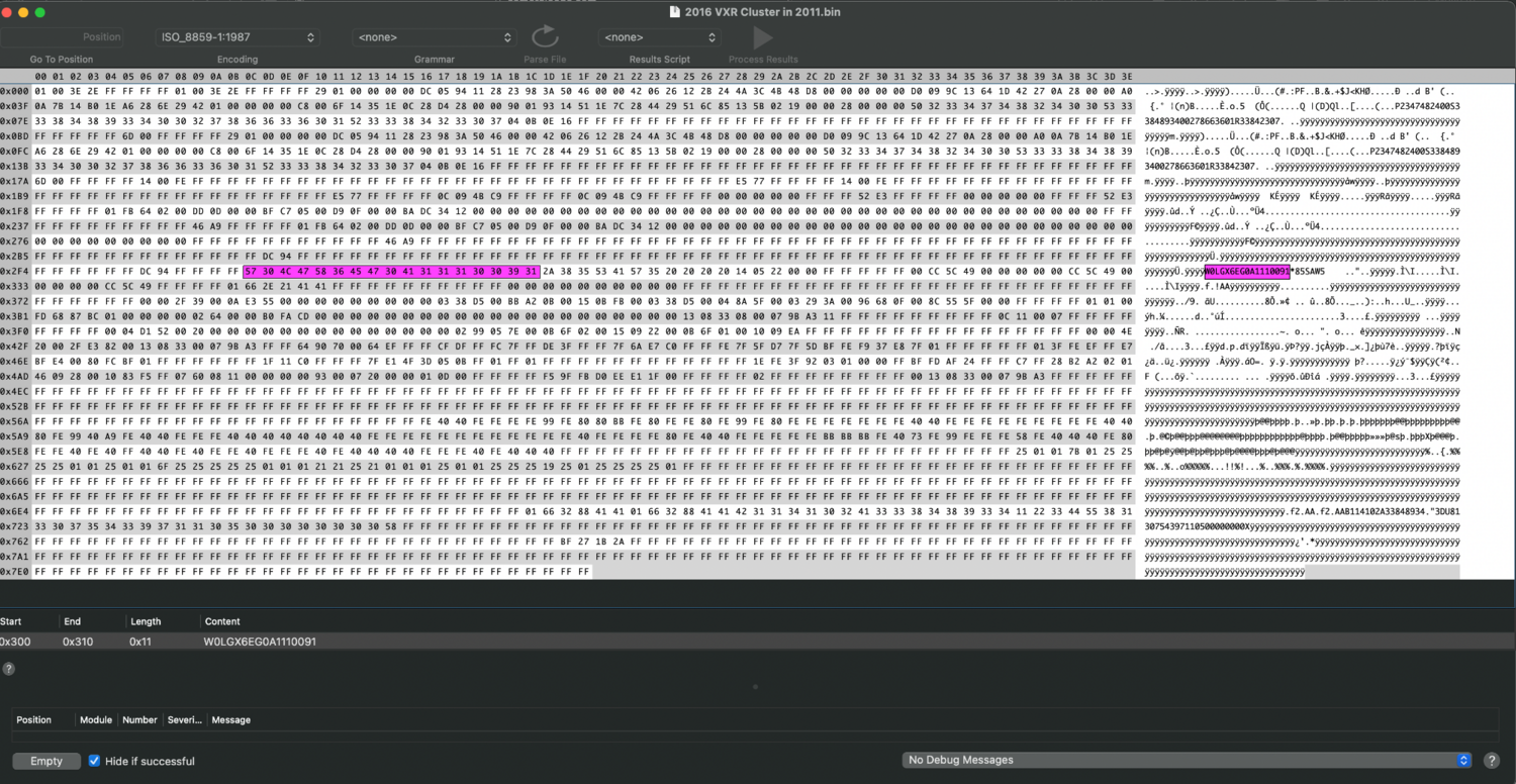

Hi all. I have 8inch cluster, PN is 26221823 (from biuck lacrosse, but panel is without eeprom). Maybe anybody have eeprom data for that cluster ? My eeprom is empty because i got this cluster without eeprom.
If you mean you need eprom dump .bin file. You could try these.

Gds2 i have not tryed yet. I want to take an eeprom dump from the forum and read the pin and vin. Thene i can chance the vin via XML? Does anyone can provide the right XML?
As long as the security access is correct, you can change the VIN with any XML file. However, to resolve the "incorrect environment identifier" error, you absolutely need to change the PIN to the one assigned to the vehicle and perform an immobilizer relearn.
Can anyone provide an dump for the UHS 2014? I think the dump is broken from troy...
