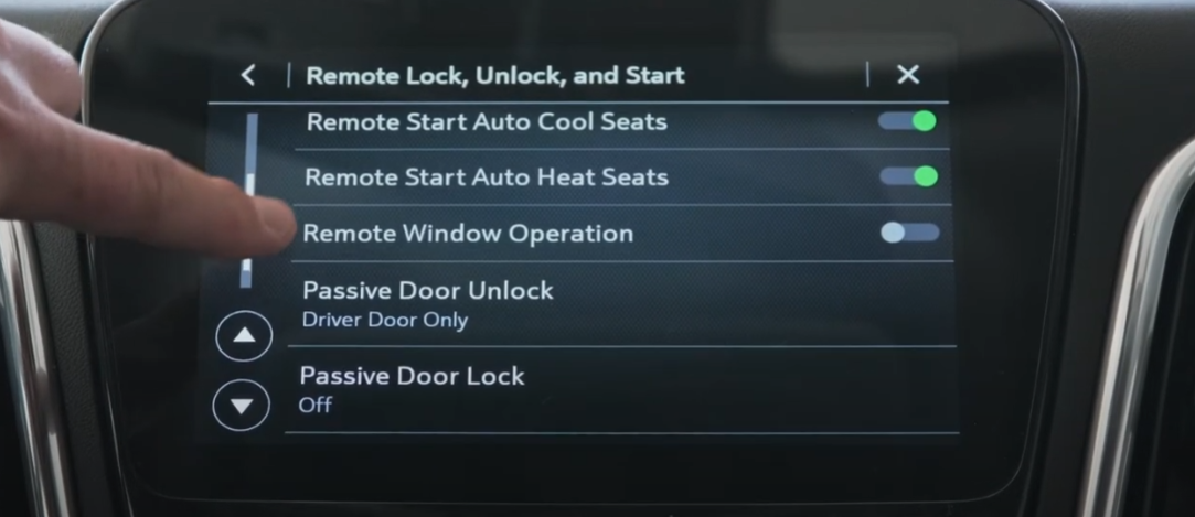

https://youtu.be/zOXOJP4yOd4?t=33
I don't known for what but i assume for air pressure?

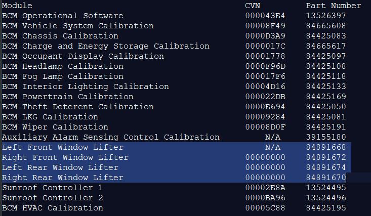

Good evening! I downloaded the BCM calibrations, you can see if it is possible to disable the window lifter opening function.
84425133.bin 84425169.bin 84425191.bin 84425118.bin 84665608.bin 84665617.bin 84891668.bin 84425195.bin 84891672.bin 13524475.bin 84891670.bin 84891674.bin 13526397.bin 13524495.bin 84425050.bin 39155180.bin 84425083.bin 13524496.bin 84425081.bin 84425108.bin 84425097.bin

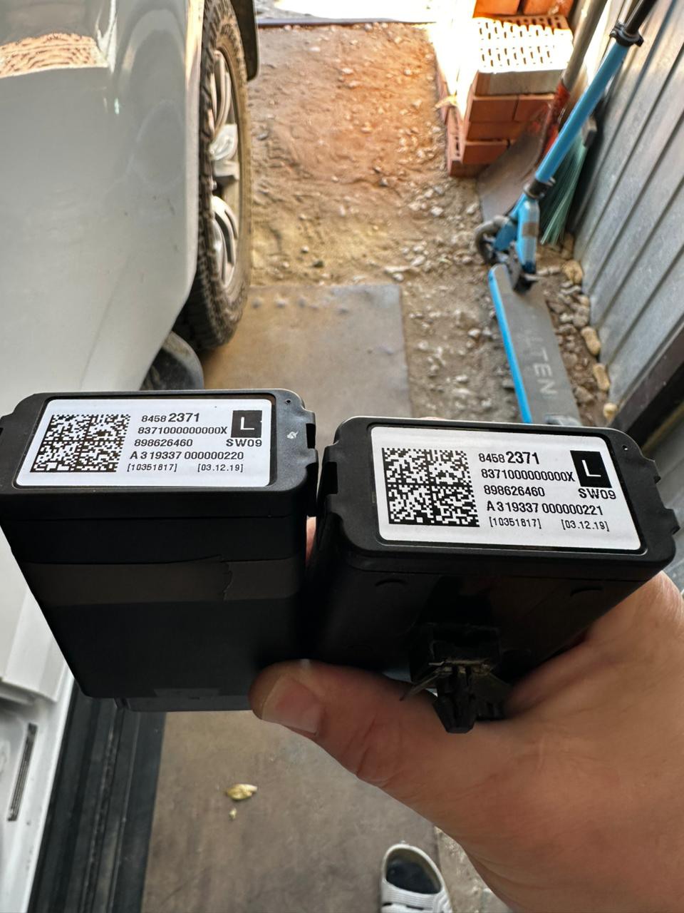

I'll continue the topic. After swapping the control units between the front left and rear left doors, the rear window started rolling down when I opened the rear left door. The unit numbers were the same. Is it possible that these units have different firmware? Or do the calibrations in the BCM somehow access these units by numbers? If I compile a DPS file from the calibrations and paste the contents of calibration 84891674 into calibration 84891668 using a HEX editor, correct the checksum, and program the BCM, will it work?

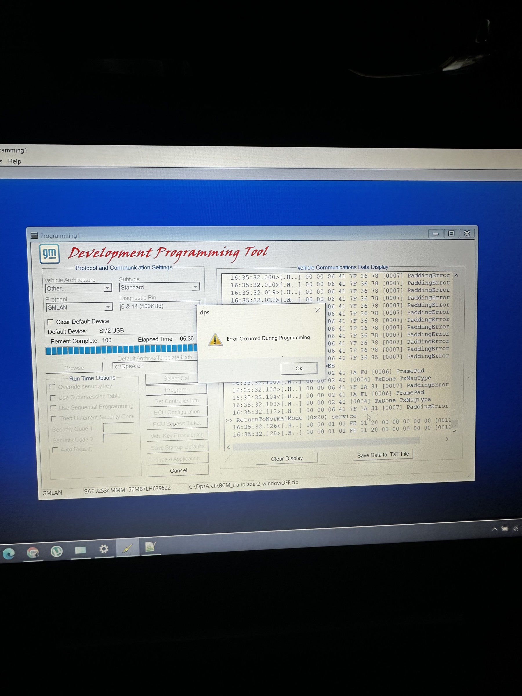

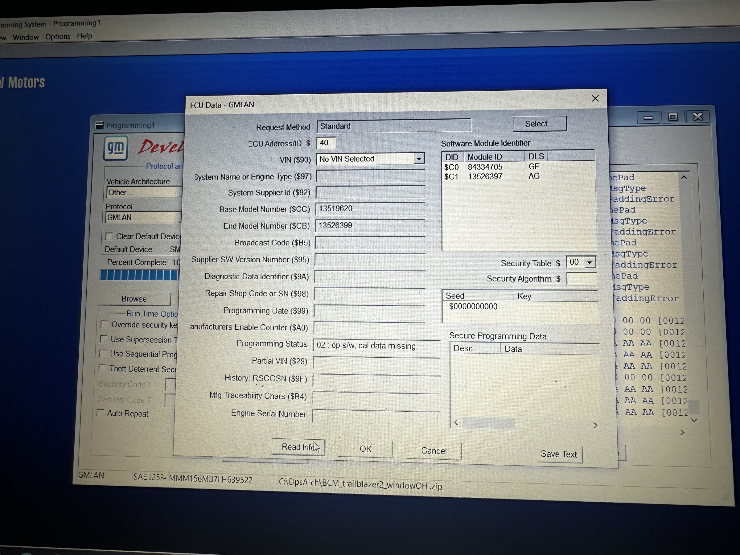

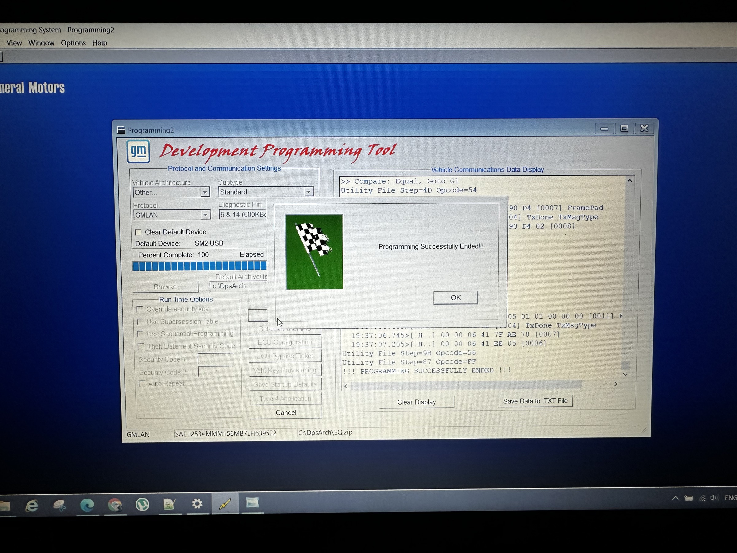

Let's continue))) So, after making minor calibration changes under number 84891668, after flashing the firmware, an error occurs and the BCM is not read correctly. After making the calibration changes, I also adjusted the checksums through the service, but that didn't help. I also tried doing it without changing the checksums. Am I doing something wrong? Can anyone suggest anything? In programlog_ok there is a log of normal firmware, and in programlog_error it is after flashing the edited calibration
ProgramLog_ok.Txt 84891668 ProgramLog_error_668_5555.Txt 14_84891668
It's look like you had a bad DPS package that results in a "bricked" BCM (Don't worry, it can be restored)
In case you are unable to restore, I've attached the DPS package that is downloaded from what you've sent.

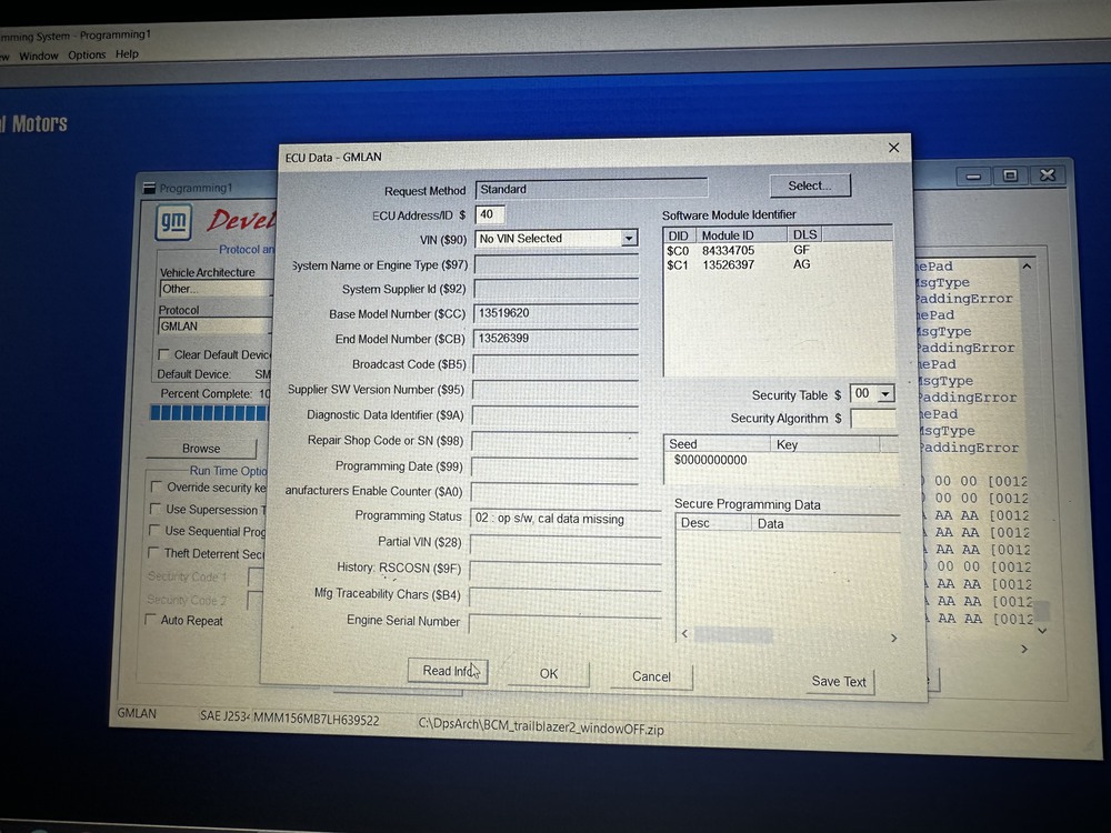

Continuing, it turns out that whatever was loaded into the BCM, I loaded the 2013 calibrations specifically for the window lifts, and completely flashed the BCM from an Equinox. The windows still open, so the problem isn't with the BCM firmware, but with the units themselves. Now I need to figure out how these door units are flashed; apparently, the only way is by directly reading the flash memory. I don't know if the video file will load or not. This is a flashed BCM from Equinox. The BCM won't turn on, but the windows keep opening.

Thanks! I also have the correct file for BCM, so I'll keep experimenting)))

Interesting... Have you checked on the techline to see if there is a "comfort" module aka this specific part?
I wrote to the US, they sent me to Thailand, from Thailand they redirected me to Kazakhstan, and I know our people, they don't always know which side to approach the car from)))
