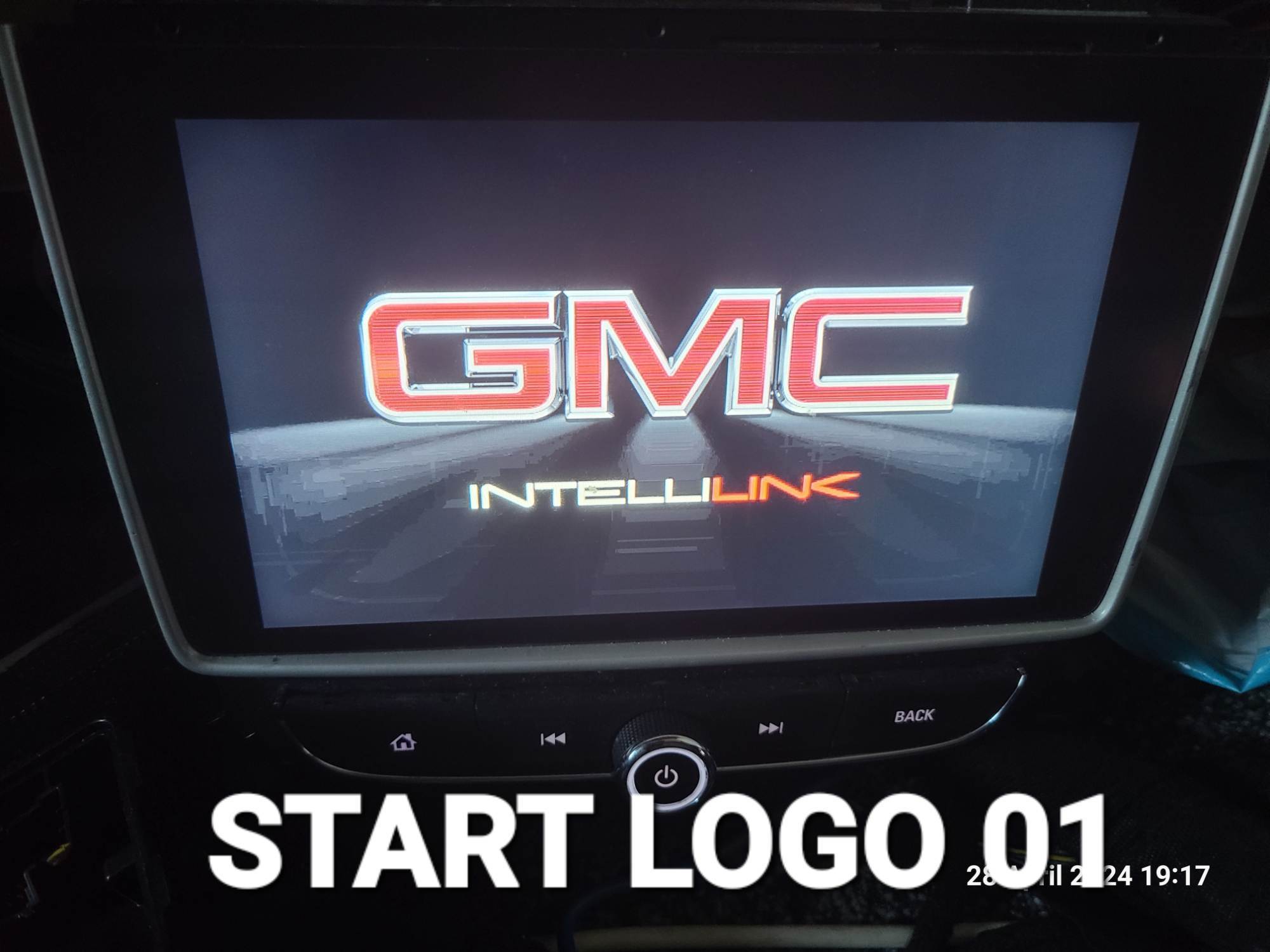

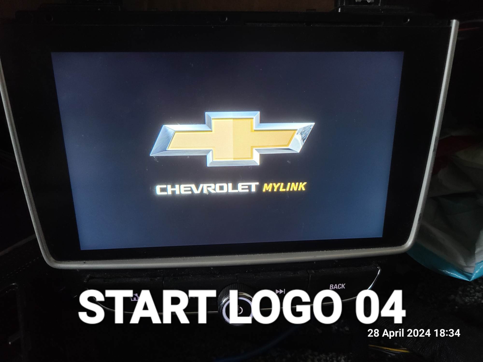

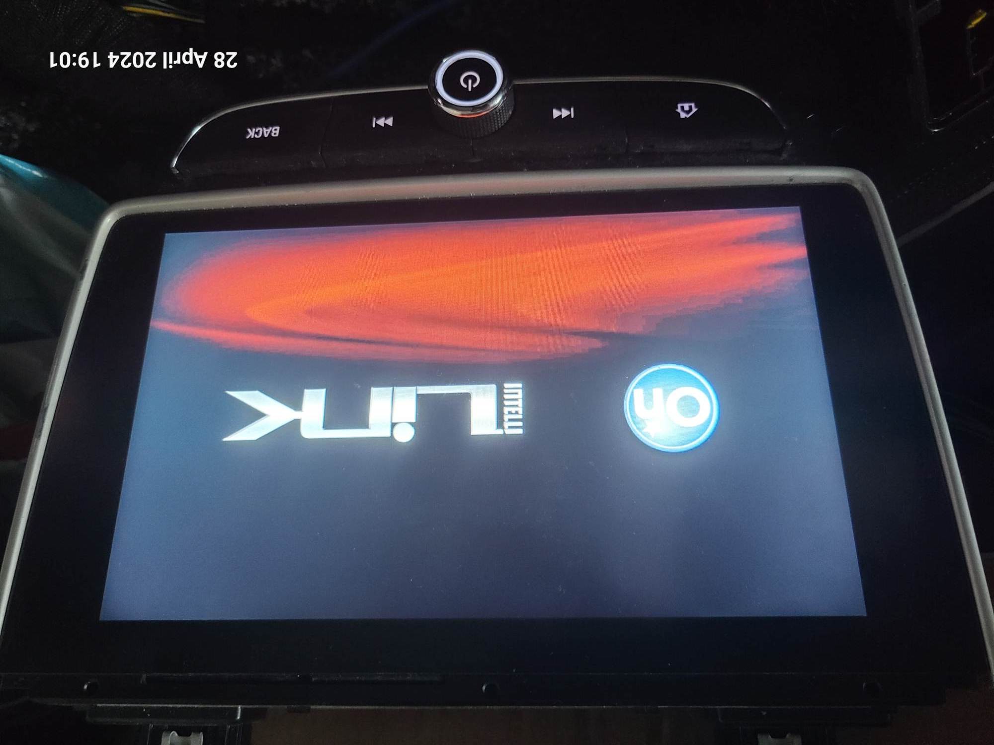

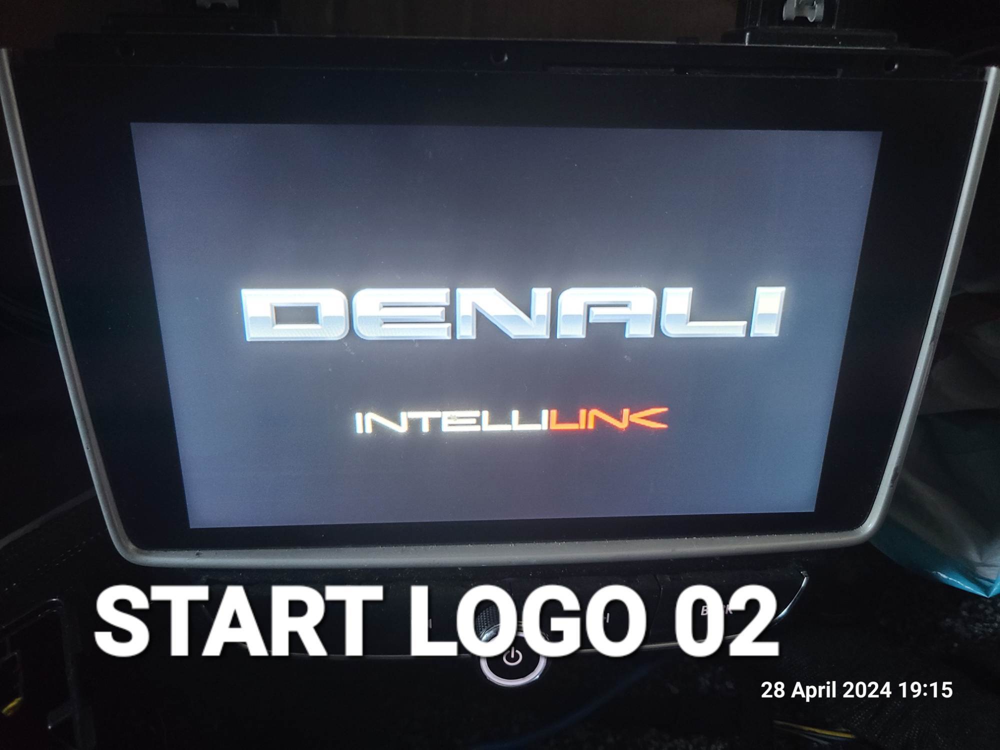

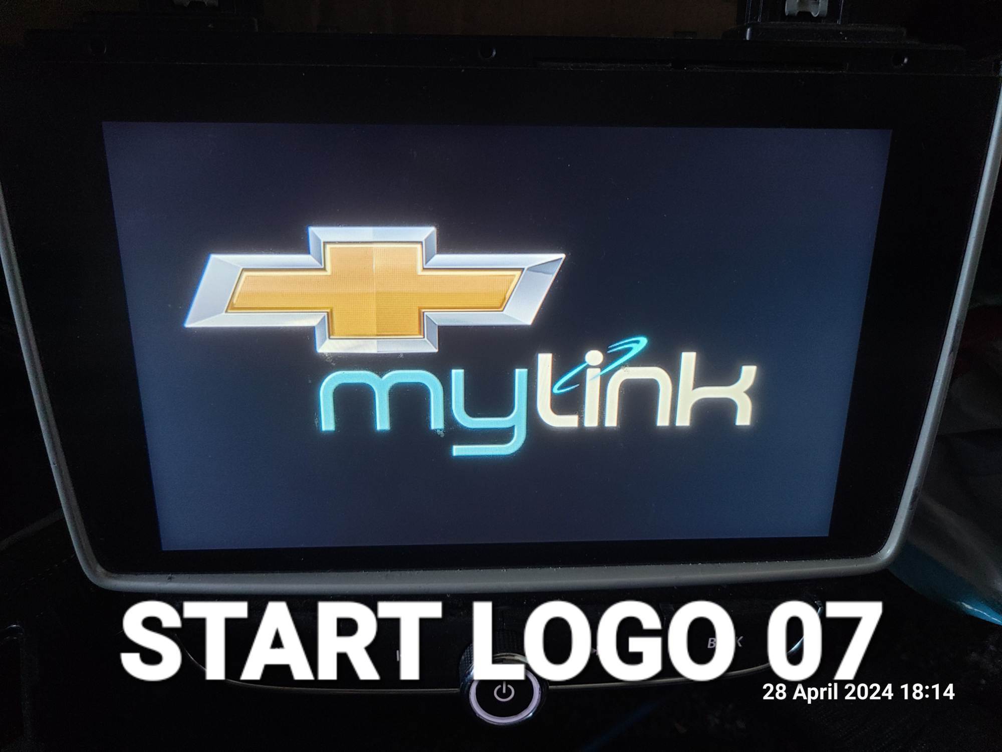

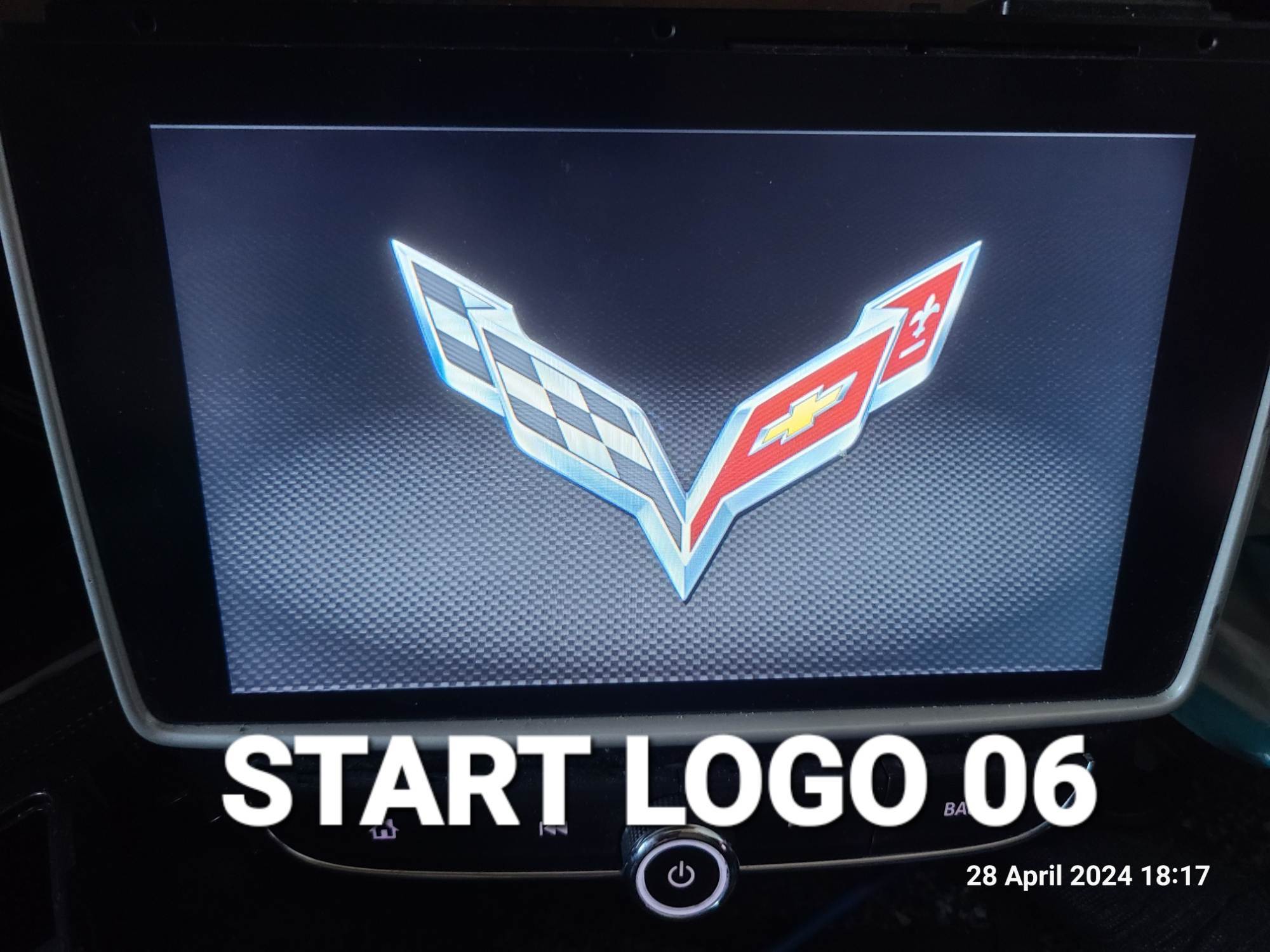

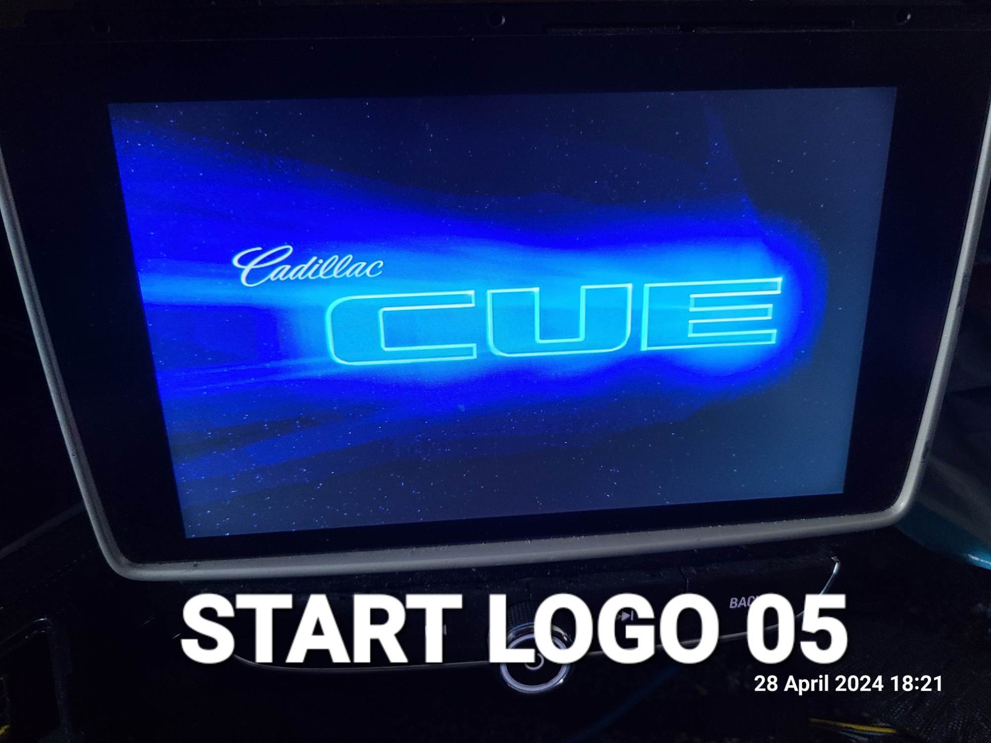

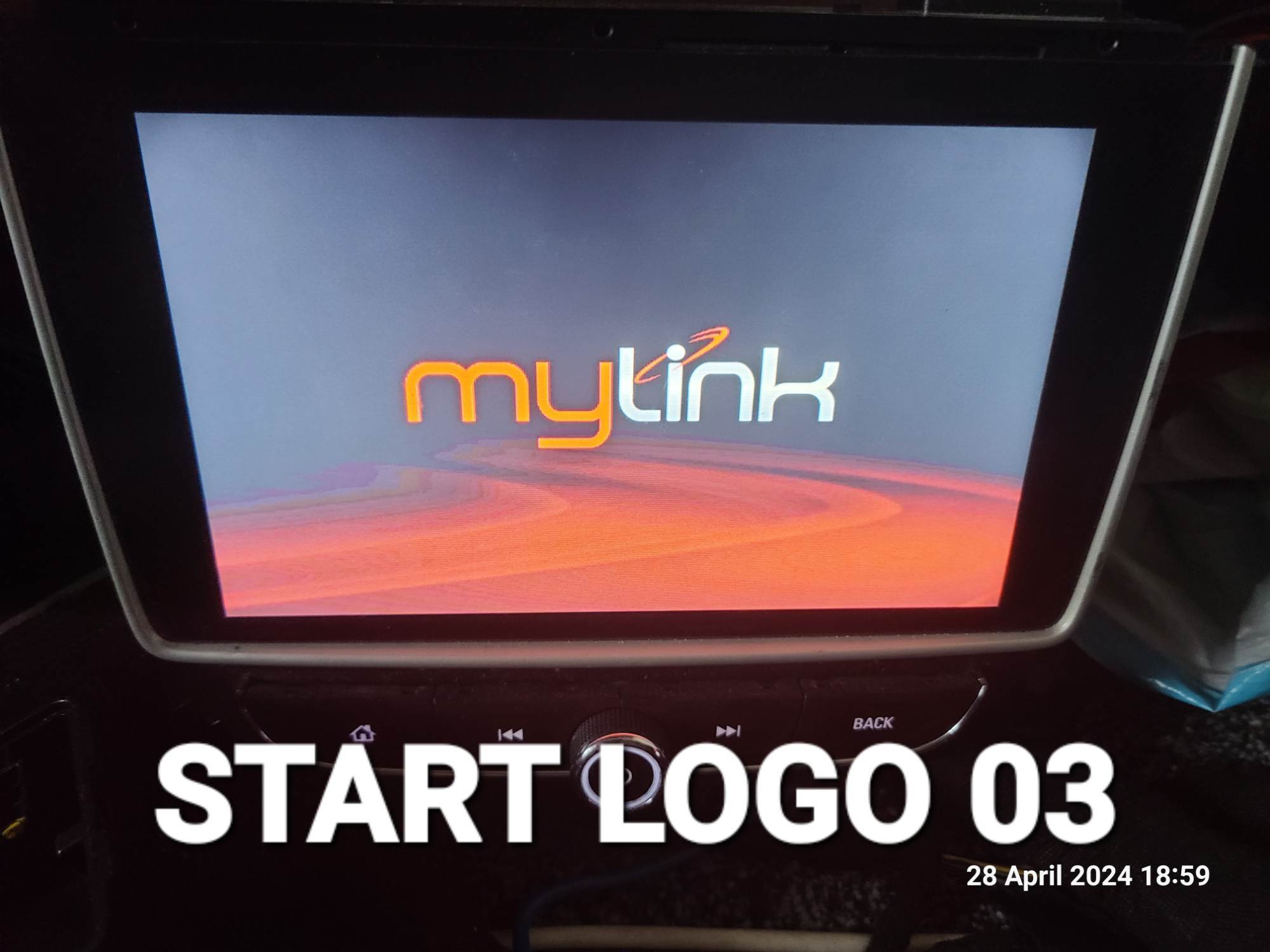

Hi
Is possible to change Thame and start logo for any files on calibrations no.720240428_191551.jpg.2b540bc18ced6bc24d7acdf2c13bbe83.jpg
99% sure you can
yes you can

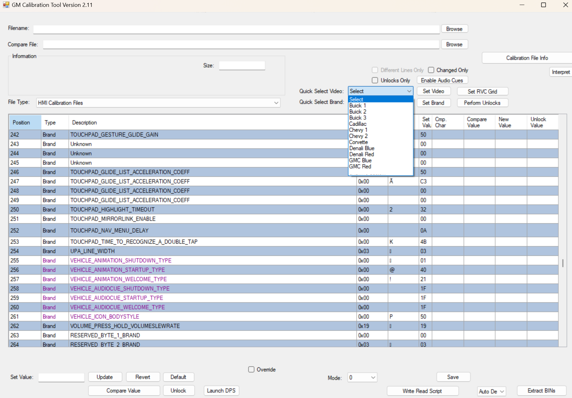

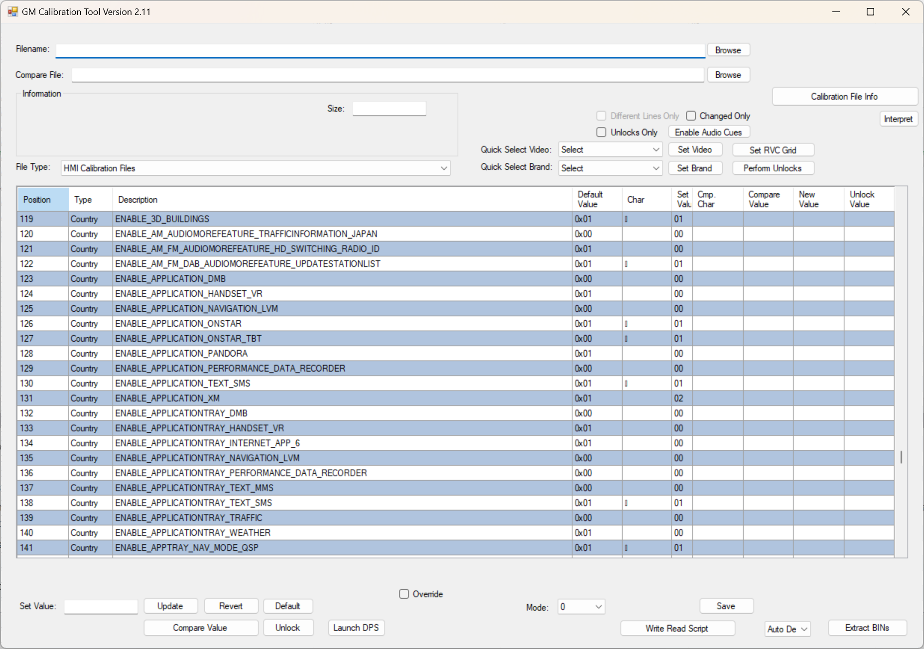

I haven't been around as much lately but I have written a tool to modify all of the calibrations.  The default after update in Cadillac's state is actually just because the values are all returning to default.  You can still download the USB update from SPS but you have to pick an older part number.  I couldn't honestly tell you off of the top of my head though if it's as new as what came with the newer HMI's.  If I get some time later, maybe I'll throw my bench setup on and see if I can make that hide/show.  It might be the internet app 6 but I can't recall.
For the person asking about changing themes, yes, it's possible (you can do custom too but that's more complex):
that is a nicely done tool!  are you referencing the calsets.db for any given ecu or just select ones?

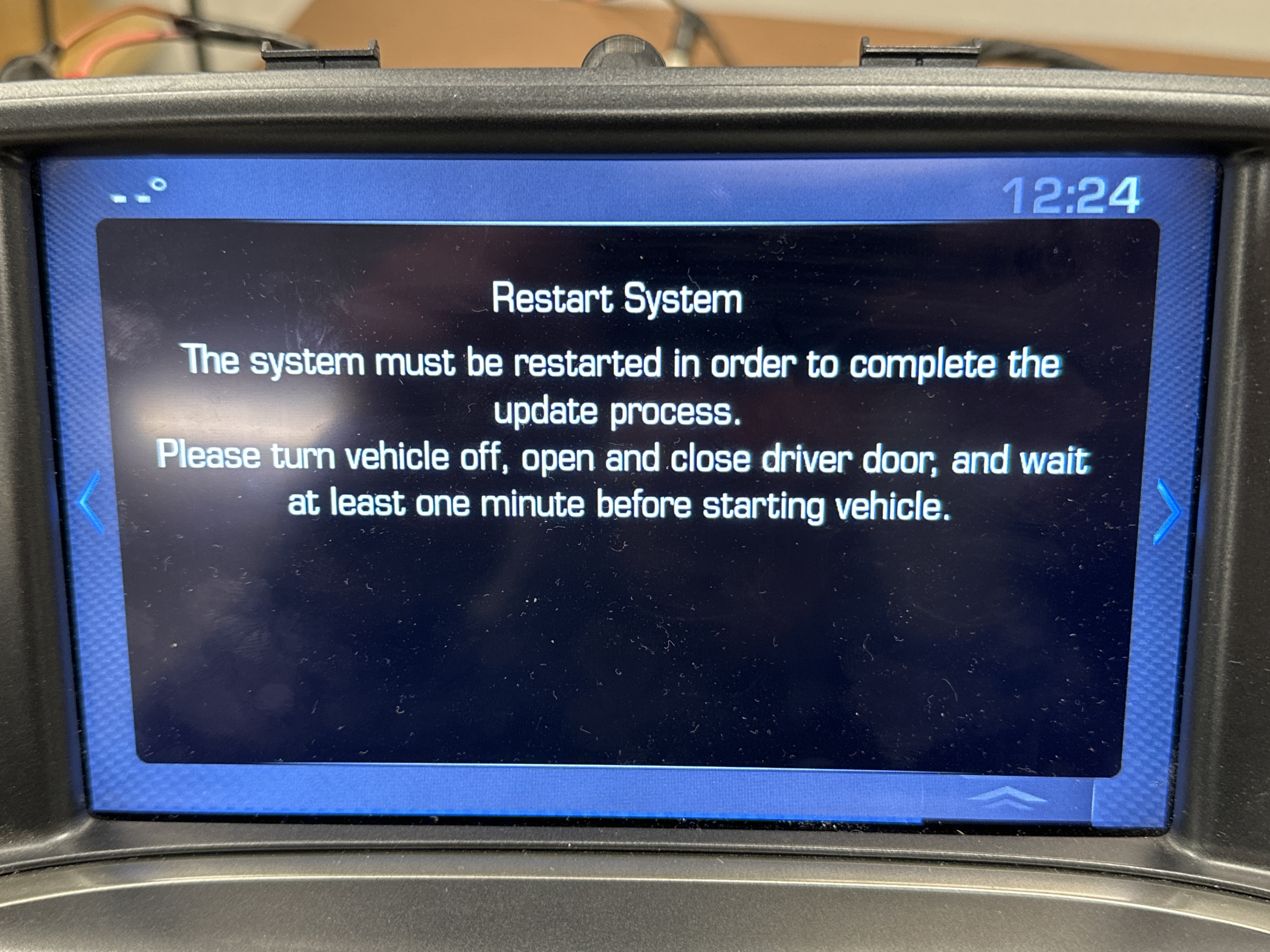

After instaling firmware update on the bench I have "restart system" message I can't pass. It pop up even after restarting the HMI. Does anyone know how to skip it? Thank you
You need to put the car to sleep in a meadow, usually it helped to disconnect the IPC, then disconnect the power supply and after 2-3 minutes connect it and then connect the IPC
You need "emulate" the open/close door. with the driver's Power Window Motor you can do it, it control the open/close signal via LIN BUS (and the door lock, you can use a switch to GND)
This happens with the IPC Firmware and Radio mainly.
