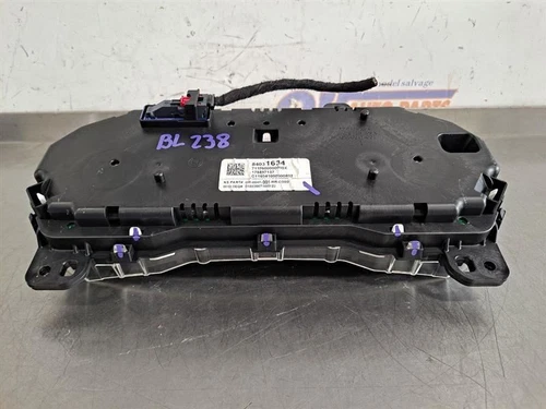

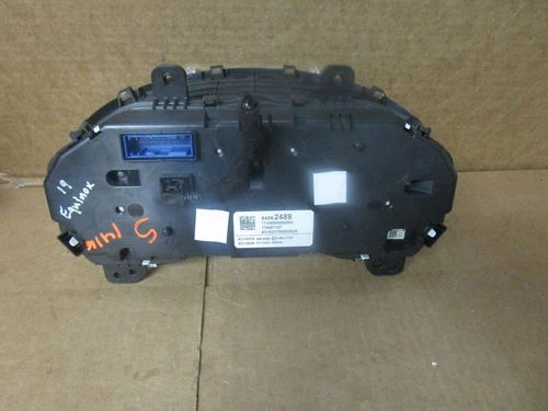

Here are pictures of the cluster. The larger connector I believe is the same except for the mini usb part. Not sure if the usb is critical for the cluster to operate. I can definitely use the UDD malibu cluster but then it leaves me with an non functional audio menu, my vehicle is not equipped with HMI. I have monochrome UDC cluster
2019 equinox cluster
19 2019 Chevy Equinox Speedometer Instrument Cluster 141K Miles 84562488 - Picture 1 of 419 2019 Chevy Equinox Speedometer Instrument Cluster 141K Miles 84562488 - Picture 2 of 4
2016 Malibu UDD
Speedometer Cluster Z 4th Digit New Style VIN X MPH Fits 16 MALIBU 2991467 - Picture 1 of 12
16 2016 CHEVY MALIBU OEM SPEEDOMETER INSTRUMENT GAUGE CLUSTER 84031634 - Picture 5 of 12
2016 Malibu UDD

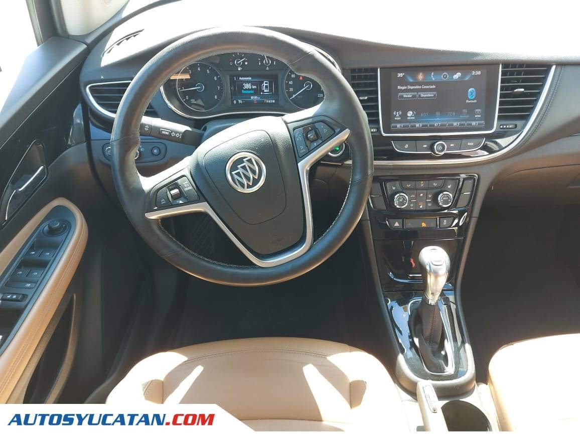

It is true that, for example, in MOKKA/Encore the UDD works with the same controls as the UDC. Strange things from GM...

In encore/mokka i see that:
UDD Clusters with UDC Controls.
But if you install a UDD with LIN controls in a car with UDC controls
 you must install an adapter (for example stalk2lin) so that you can move through the instrument panel menus. At least that's what I understand from what has been tested here in Europe.
I have read that it is not possible to make a UDD LIN work by changing calibrations so that it works with the UDC controls.
But, there are cars with UDD without IO5/IO6 radio systems?

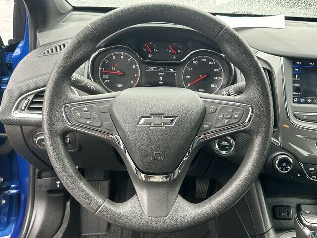

So on the 2017-2019 Chevrolet Cruze, it uses the same steering wheel and stalk between the two clusters.
The steering wheel buttons work just fine with the UDD cluster except for the two radio volume buttons on the back of the wheel and the two tuner buttons on the back of the wheel..
UDC
UDD
If you know of a car that has the UDD cluster w/o IO5 or IO6 let me know and I'll go on the hunt.
