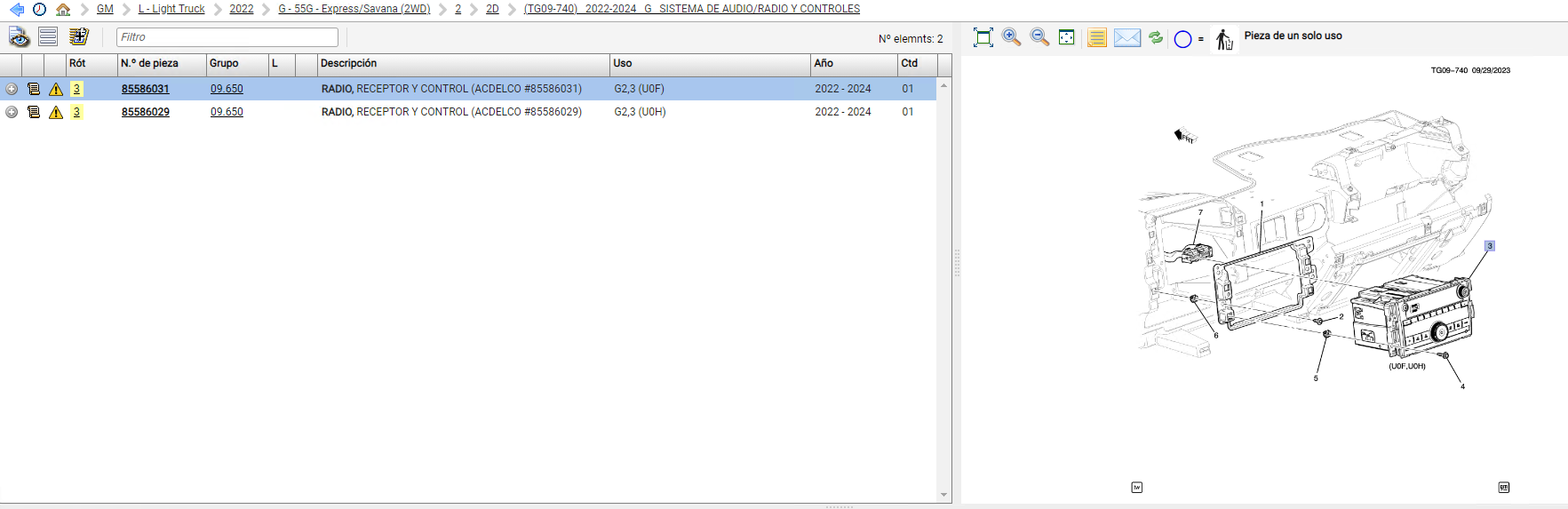

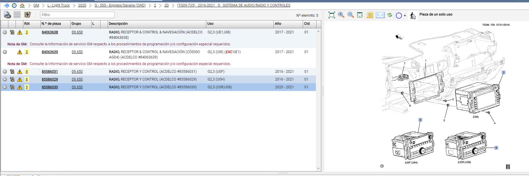

I dont know what type of GM Platform uses Savana but not seems a Global A
for 2022 there are only 2 radios:
For prevoius years there are more:
Is the little i can tell you.
If some one can help more.... but probably you need change the radio
