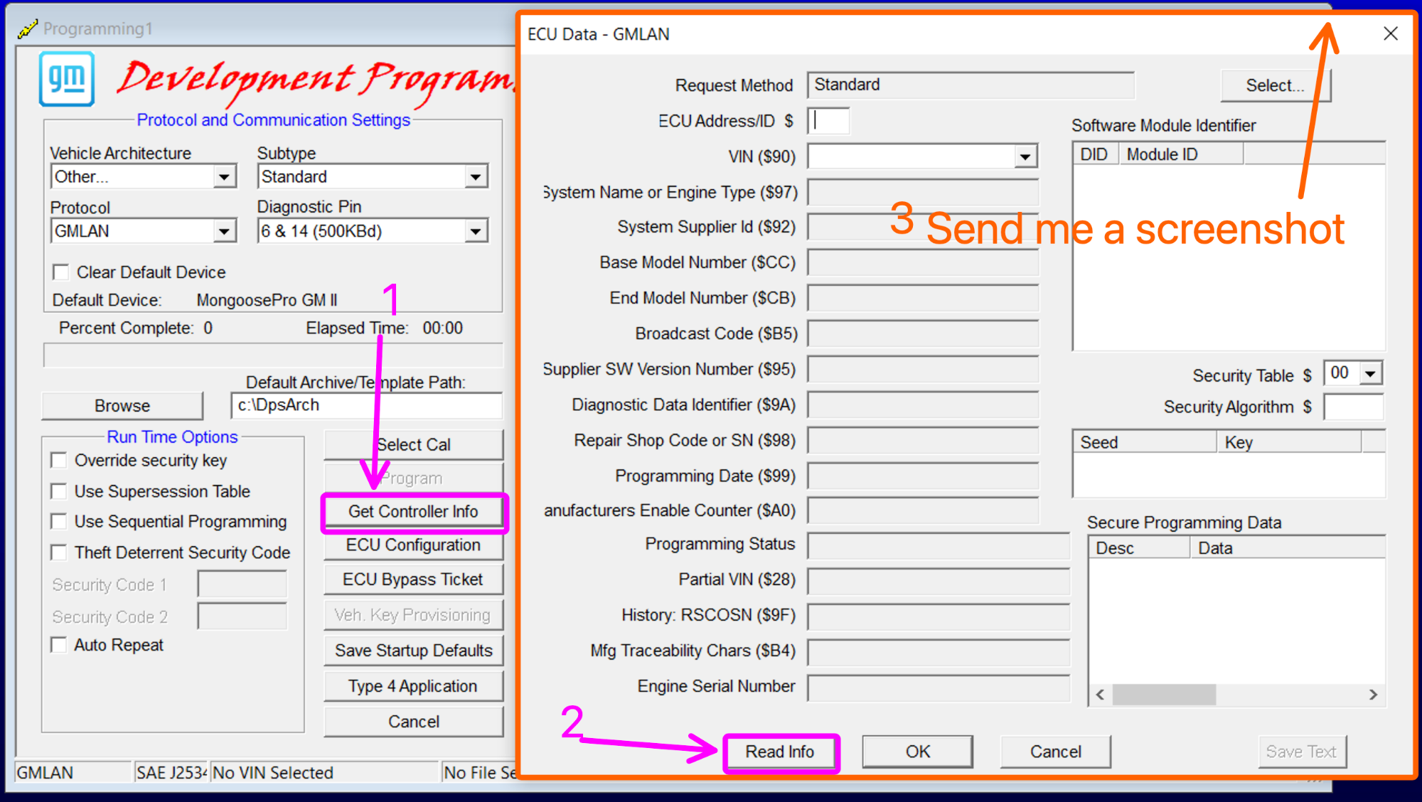

  • What’s the ECM model number? Example E39.    Use the DPS "Get Controller Info" option to read the VIN and then send me a screenshot of this page in a Private message.
