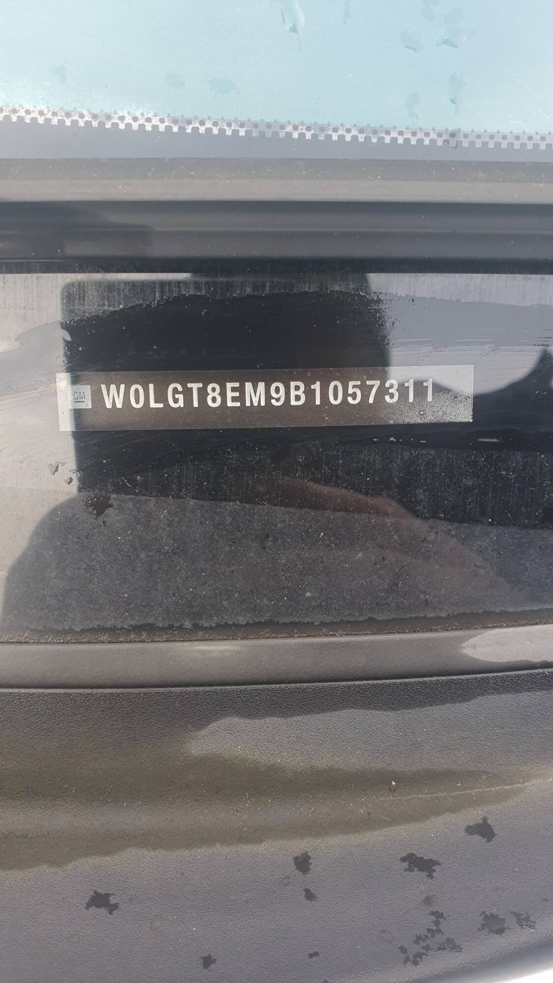

Hi vin number is attached,I would like a file with halogen headlights instead on xenon,thankyou
