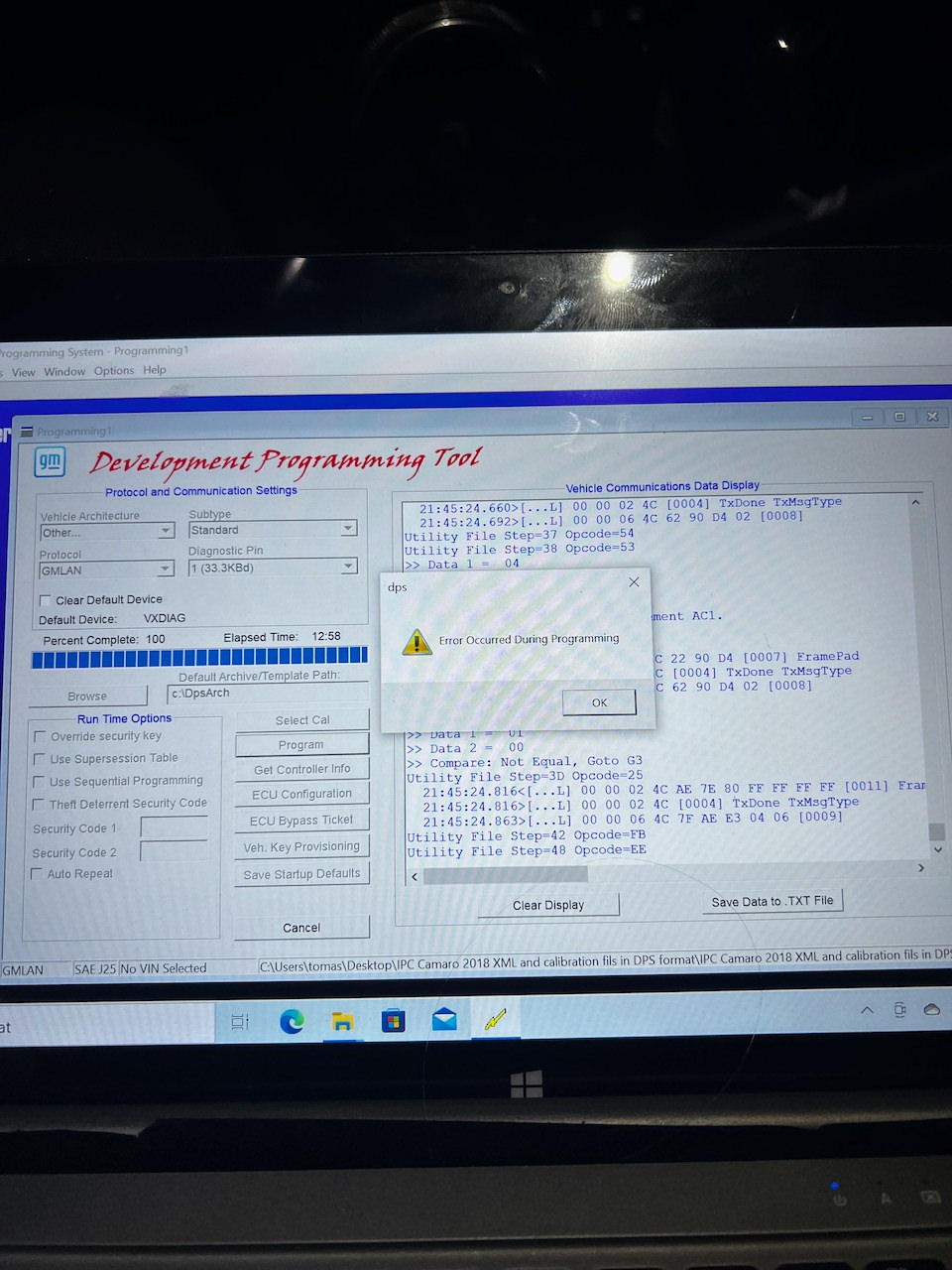

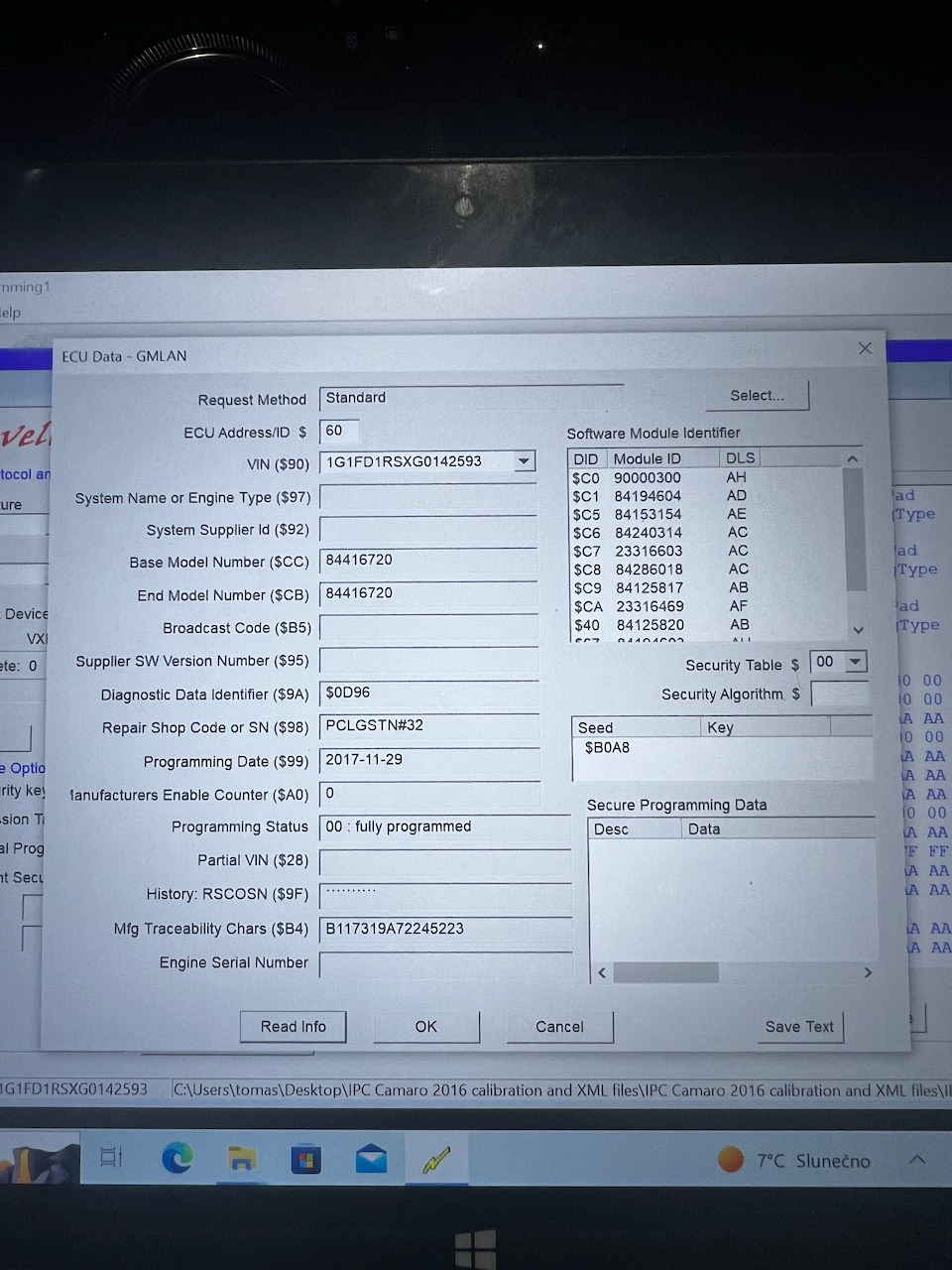

Thank you! I tried program IPC but it ends with error. Log and some photos are attached. Can you help me what I am doing wrong?
ProgramLog.Txt
The log is saying the calibration files are not made for that IPC.
Did you upgrade the IPC to a newer Model IPC from a later or lower vehicle?
Did you save the VIN that was programmed in the USED IPC? If so, send me that VIN.
Yes exactly. IPC is newer model and it was from Camaro ZL1. Fortunately I saved old VIN it was 1G1FJ1R64J0141197

Thank you, Troy. At first I tried IPC calibration files. After 12 minutes of programming I have got error again. Log is attached. I hope it will have solution 🙏
ProgramLog2.Txt
It was programmed 100% ignore that error.

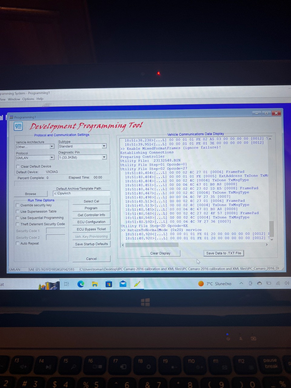

Yes 👌thanks. Now I was able to delete error codes from IPC. Excelent ! I will try disable warning messages which I don't need 🙂
I know why the error at the end appears. When I clicked on 'Get Controller info' before programming IPC, the process ends successfully 👍
This error at 100%, can be solved if you check the box theft deterrent Sec code and input in the boxes the actual code. some units after load calibrations ask for the sec code to complete the process. but, if don't check the box, the calibrations loads OK and at 100% you get a failure message.
