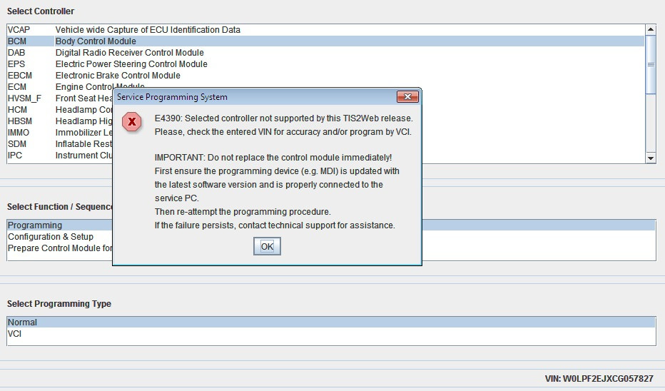

Try this W0LPF2EJXCG057827
my globaltisv32 says E4390.
 Hi!
  GlobalTis v32 Offline does not have calibration files for cars with model years 2012 or less. 😞
U need online. Provided VIN is for MY13 vehicle
yes, guys, I know that globaltissv32 only knows the car's vin up to MY12.
