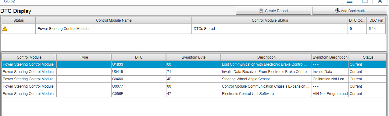

hi all can someone help me in this issue i have Chevrolet malibu 2017 and this car power steering control module is dead and now i replaced it with used 1 from the same model malibu 2017 and its giving me few errors and steering wheel turning hard below is the dtc information and when i trying to program it with sps2 its giving me error with my car vin and when i tried with scrapyard car vin from where i take the power steering its program normally so what can i do ? my car vin is KL1ZA5CAXHB713629  and used steering module vin is    1G1ZB5ST3HF157867

thanks for reply ..its giving error when config and setup

84187572  GEAR, ELEC DUAL PINION RACK & PINION STRG (CODE BXP) (ACDelco #84187572) ZB,ZC,ZD69 2017-2017 01   9A 0214A,, BOTH VIN YOU HAVE USE SAME EPS PART NUMBER,, THE MODULE WAS LOCKED,, ONLY U CAN DO IS VIN/CHANGE PIN,, THEN YOU CAN DO REPROGRAMMING AGAIN,,

hi thanks for reply.. how i can change VIN?
Go to Search ,, Type EPS Malibu,, links will appear  ,, for exact file send message to troy..
