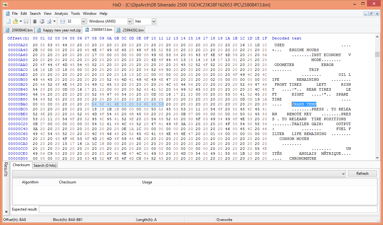

I have DPS and can pull files from the SPS.
I found the clear text in the binaries.

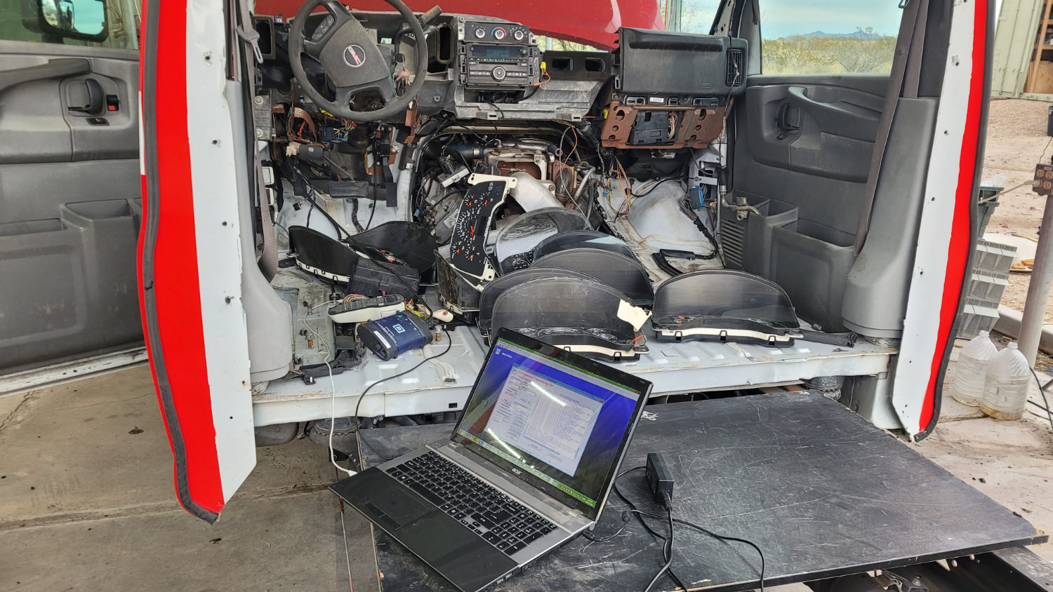

I have tried putting a 13 calibration into a 2008 cluster using DPS. It threw an error and the cluster is now bricked, and not responding.
Then I tried to put a 13 calibration in a 2012 cluster and it is now stuck in an infinite reboot loop.
I have a few more clusters I can afford to kill, but is what I want even feasible?
I am pretty sure the ECM is broadcasting the trans temp over GMLAN (because why not). Where are the instructions for the DIC stored, to pull the proper information?

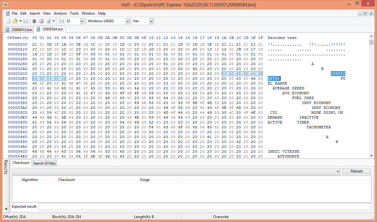

Are any changes to the BIN files allowed? Can I change, for example, "SPEEDOMETER" to "   SPEED   ", and have it program successfully, or is there some sort of checksum validation happening internally?

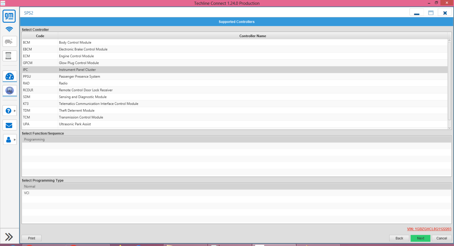

How can I get the XML, as SPS only puts 3 bin files in the cache folder?
XML files come from Setup, not from Programming option
image.png.363987019e5b6e881773fc60a0a878ad.pngAnd if there is no Setup, what can I do?

I still was not able to obtain the XML, there is no IPC "Setup" option in the SPS for these vans. Does anybody know?
