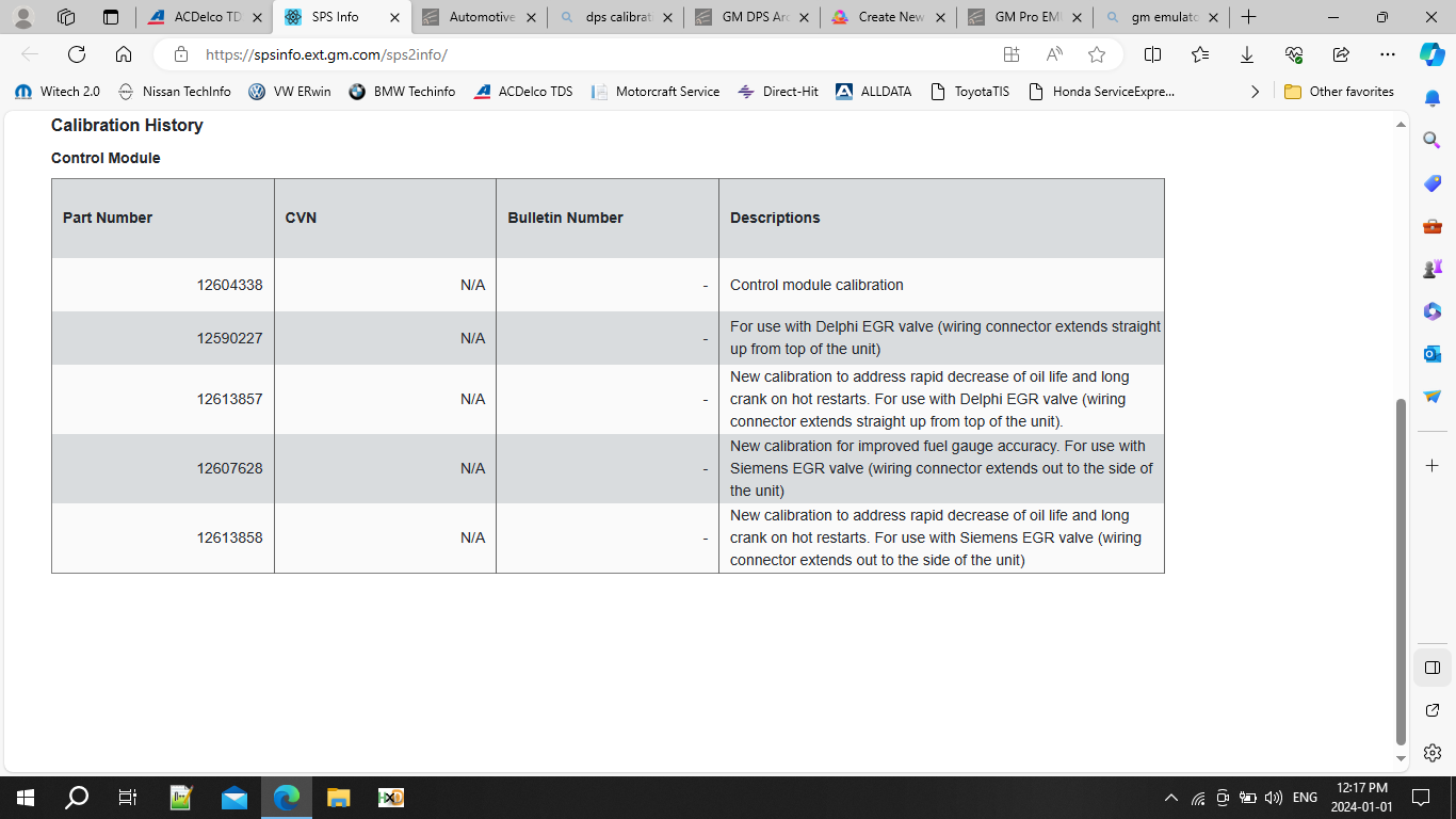

Hi, I am looking for calibration files for a 2006 Malibu.  If anyone can help out I would really appreciate it
VIN 1G1ZT51806F136997
12604338
12607628
12613858
Thankyou

TIS2000
The used PCM is from 2006 Torrent. I can update without issue. When the Malibu VIN is manually entered, PCM is no longer present in remove and replace list. Need cal files for DPS
this car was US built for Japan,, RPO LX9 v6-3.5.. program ecm by TIS2000
Hi Kirill Kirill   I appreciate you sending the files but it doesn't look like they are the ones needed for the 2006 Malibu  Should be
12604338
12607628
12613858
If you can get a utility file that would be even better
Thankyou so much
Programmed ECM with DPS  all good
thanks for the help
