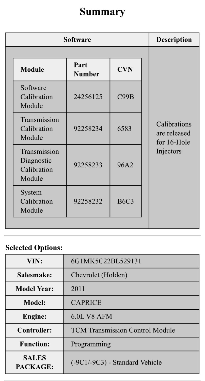

i am trying to program a Chevrolet (Holden) Caprice 2011 ECM with country Registration middle east but i am facing an issue where techline connect says no supported calibrations found. Could anyone help me with a dps archive with the middle east files to program the ecm
vin Number 6G1MK5C22BL529131

Image added
I even purchased a vin in gm Australia account still same error no calibrations found
Need to check for which market is produced that vehicle and use appropriate server to access files
your car was L77 OS 12639270, E38 GEN4, i have hpt file , i dont try  this by dps,,  tommorow i will download calibration
