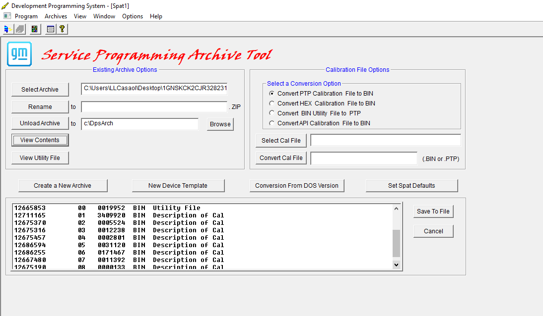

Utility 0: 12665853. share vin to check the others
or chek it in https://www.acdelcotds.com
And BuidRecord for P16 XML
BuildRecord.xmlBuildRecord.bld
Yes, my brother bought it and took parts for his car.
Yes, I saw this file  84256814 and used the sps program several times, which gave me the same result

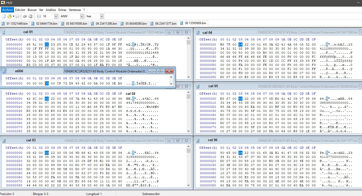

Anyway, you have to decompress the SPS cache files with 7zip. and if you open them with a hexadecimal viewer, you get the position of the file at offset 03. For calibrations, you can know the position and generate the package with DPS. Utility is always 00
You can check the order too in https://www.acdelcotds.com/
