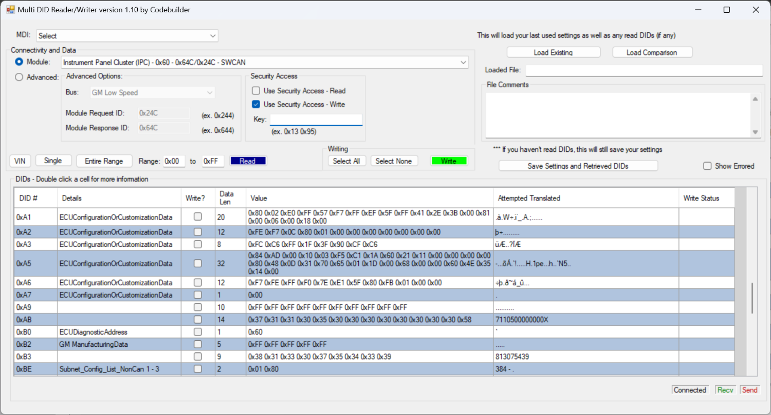

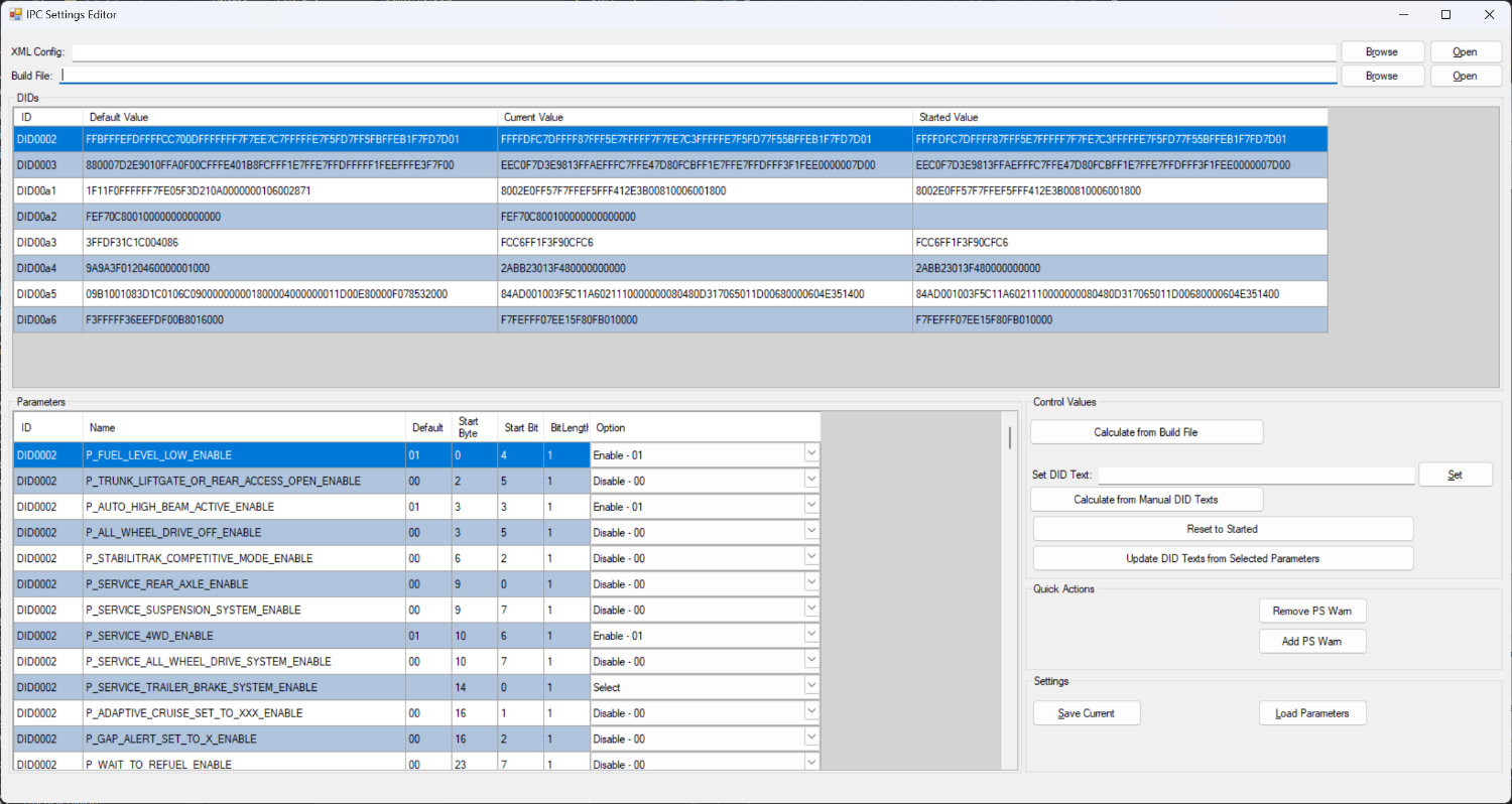

    Good addition :).  Also, 1A for read, 3B for write.  I'll expand it a bit too, I have tools that read/write the entire ranges, more for cloning.  A different view than my IPC Settings app:
Read whole file and read again. After few times will understand DID flags
You're getting not only into the byte but the bit level.
That All Wheel Drive flag is flipping a bit on the 3rd byte (under FF) - it's not super easy to calculate:
<DefaultValue>FFFFFFEFDFFFFC7FFFDFFFFFFF7F7EE7C7FFFFFE7F5FDFFF5FBFFEF1F7FD7D01</DefaultValue>
This 3rd FF value would be modified depending on the setting.  Since it's FF currently, it would be 11111111.  If you removed the All Wheel Drive, it would become 11110111 (F7) - Note - I might have this backwards lol, going off memory.
Nice app. You cant calculate seed/key?
Thank you.  I can add it but I built it for a one off task so I just did it quick.  I have it in a module now though if I really wanted to add it.
Let me know if you need any help with implementing or testing your app. It looks like we live close to each other.

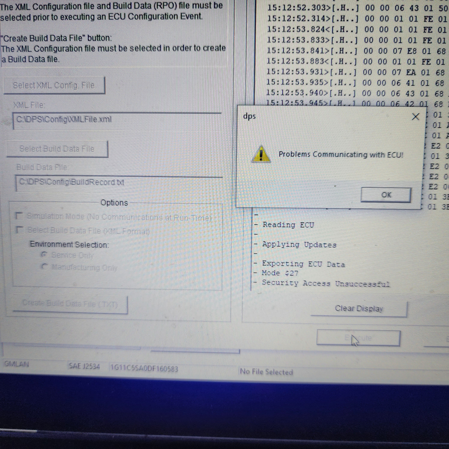

Any idea whey I got this error when writing the xml configuration file " security access " is there security algorithm block I need to modify
