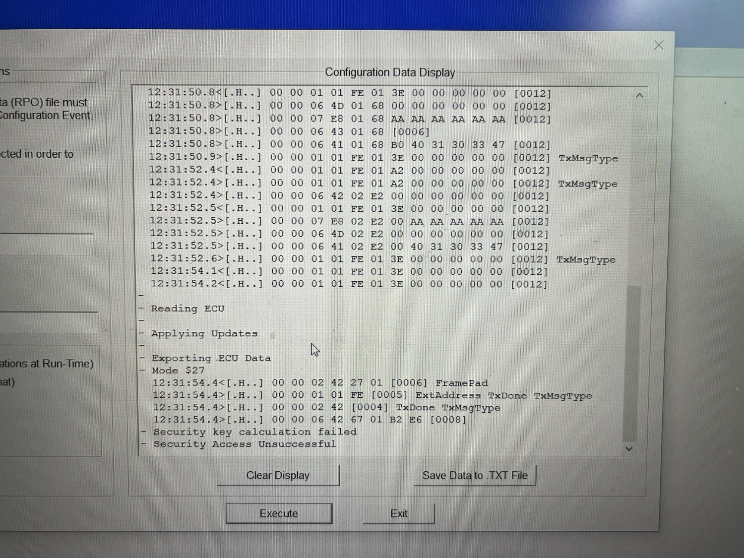

I am trying to do a config of the EPS in order to be able to enable UJC sport mode. I was able to get the correct files from SPS and made the process to get it to work on DPS.
I often done it loads in the past when I do it for IPC. However, for EPS in this case. I was unable to execute it, this is simply due to "Security key calculation failed" - "Security Access Unsuccessful".
Is there any way to override this or a pass-by somewhere? I've attached a log file and a data display below.
Thanks!

My only guess is your XML file has the wrong algorithm specified.  I'm not sure why it would be incorrect though if it came from SPS.
How can I find out which one is correct one? I’ve attached another screenshot of what I’ve set up in case
Did the XML come from SPS or did you custom make it?

>> General Parse Error: Schema not found at path: C:\Users\RCCJa\Desktop\Astra k sPORT MODE RETROFIT\Config EPS\\01.02.02.xsd
This part was already fixed as I've made an error of not added the xsd files to the relevant folder, otherwise it would've stopped at this point and there won't be any further logs.

What are you using to program with?  VCX Nano?
MDI.
My bad. What year is car? What car is it? I never need to do EPS configuration for Sport mode
It is 2016 and Astra K.
The config of sport mode will allow it to be stiffer when enabled.
Hmmm, need to check with TIS Helpdesk. I never have EPS calibrations and configuration after Sport mode activation
