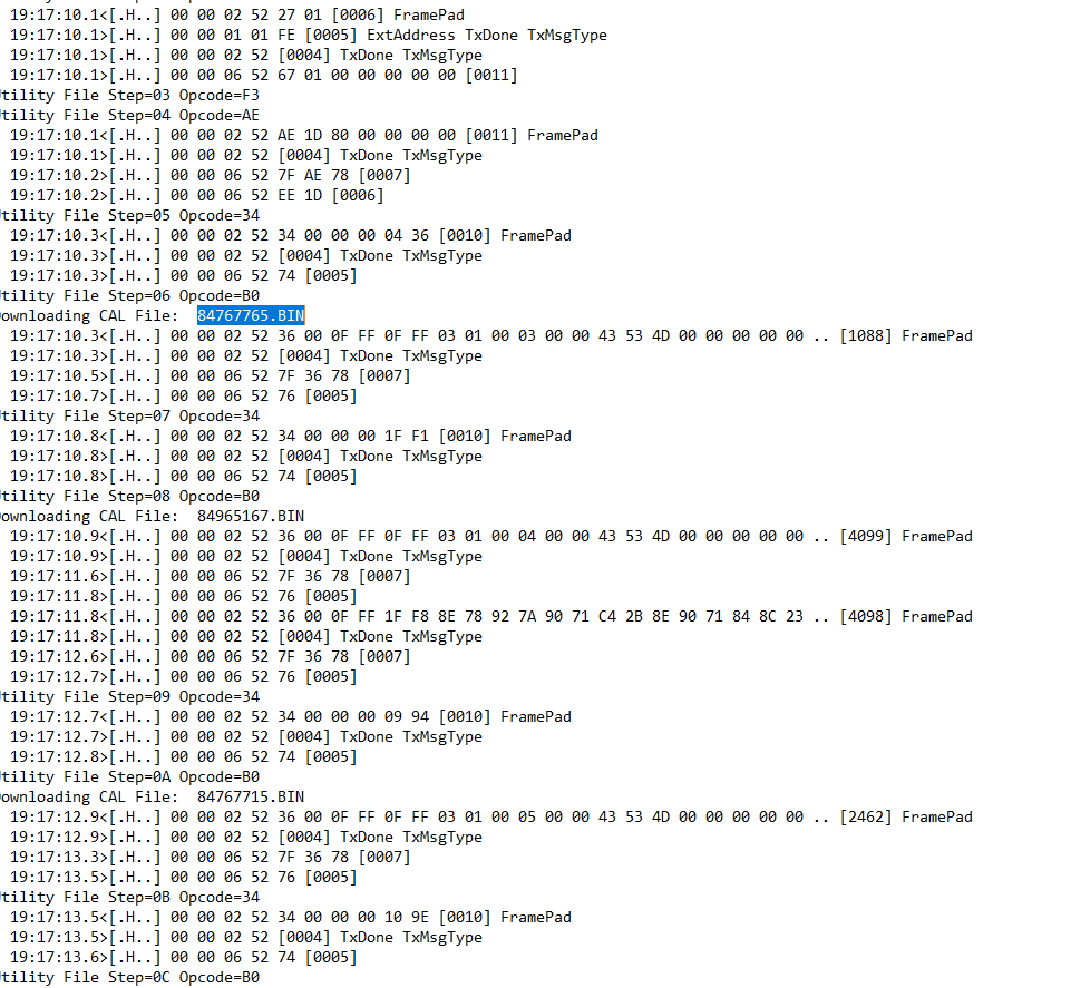

i bought an iot Harmon hmi 3.6 to upgrade my camaro from ios i successfully got rid of the theft lock thanks troy for his file  but when i try to program the calibrations i get "error Occurred FERGANA Programming "
i uploaded my log and my archive hopefully someone can help

file who collected the queue is not correct or something queue
Downloading CAL File:  84767753.BIN after this file is not correct
84767753 is the last file and it’s for the equalizer
What been original multimedia and what is target? VIN use for upgrade? Many more questions as RPOs, ect.
1 hour ago, KZV said:
look at which file programming starts with
It looks like it started with the hybrid and not radio how can I fix this in

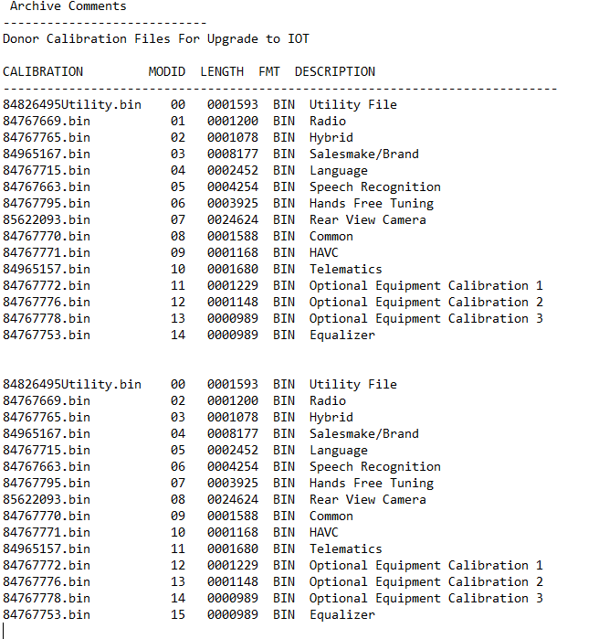

your problem is not with the DPS version
the problem is an incorrectly assembled archive
this is how your archive is compiled
Below is how it should be assembled
the software file is not rewritten in this procedure
archive must start with ID 2
yea i realized i didt change the mod.id after posting but then i was having issues with GM seed Key
