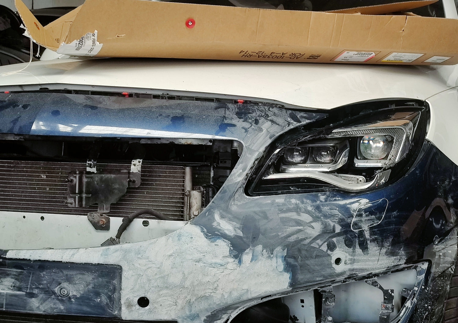

Hello all,
I'm working with my project what will have all possible Insignia A options maybe some from Insignia B( But no 4x4 as I'll try to fit Tesla motor for rear drive.) It just so happens I have few broken Intellilux headlights on shelf and decided to give it a try to fit them in Insignia A Headlight housing and with a lot of modification to the housing it did. Just wondering if you can shed some light what additional modules insignia B have for them light to work.

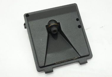

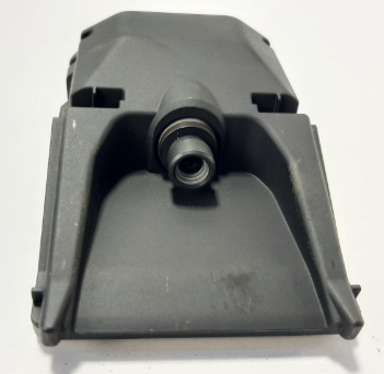

On Insignia A, the feature is "Lane Departure warning" which is just the audio warning, when Insignia B, it is "Lane Keep Assist", making steering turn back slightly in order to return back into the lane. I haven't really looked into utilise Insignia B's software into Insignia A's K109 front camera since the hardware is different.
Insignia A's K109 camera:
Insignia B's K109 camera:

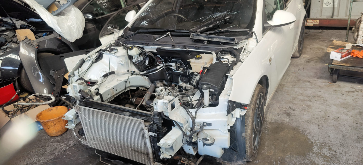

Yes it does, don't know if it works, as I have to rebuild the engine...😀
P.S this is 2016 model. And it has electric power steering column.
