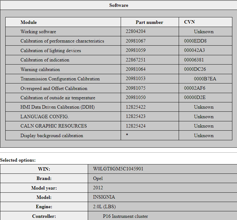

On 10/22/2023 at 6:52 PM, E-Ing-X20XEV said:
I think you have to upgrade cluster first, then find correct calibrations, when you post VIN maybe I can help you find the correct calibrations.
I can lookup RPO codes from VIN in database up to MY 2014 and try to translate into matching VIN from MY of replacement cluster.
Calibration numbers are then given by Tis2Web service.
We handle IPC upgrade 🙂

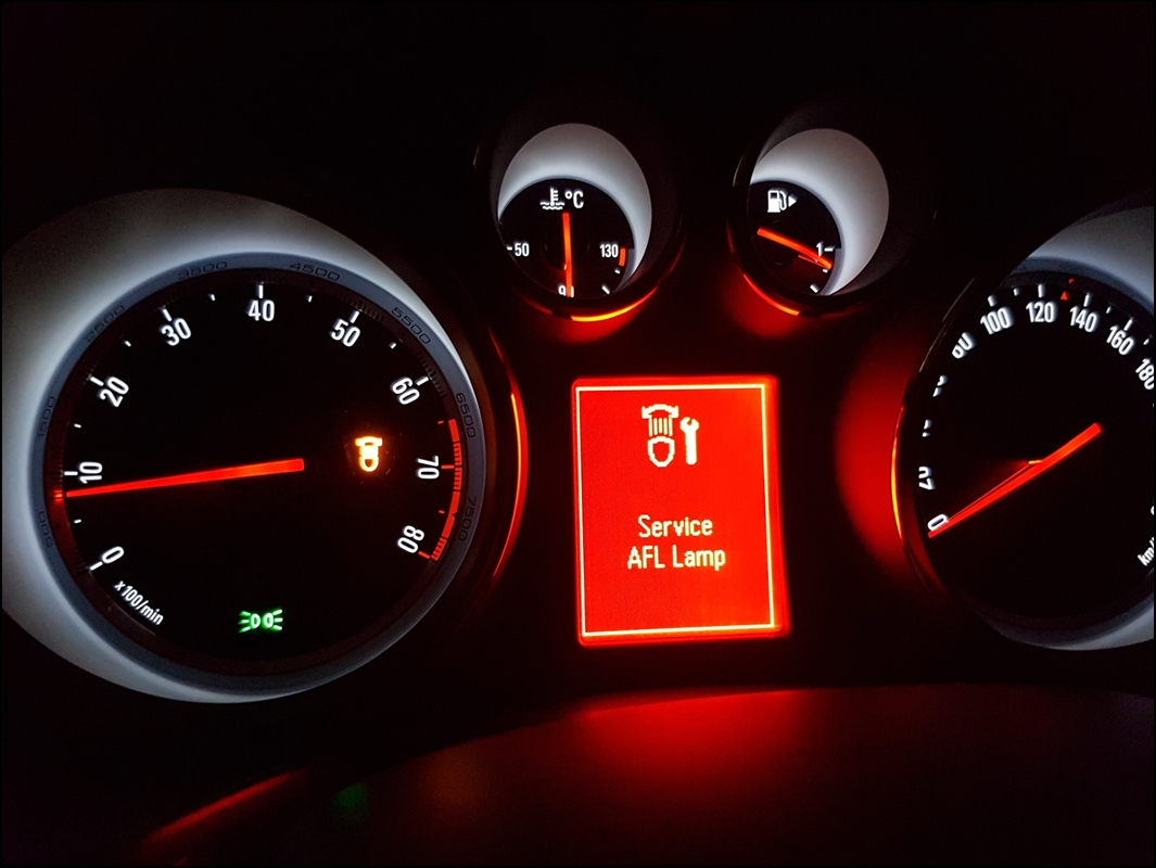

hello dear experts,
I used xmlfile.xml to add remove rpos. Even tough i removed TQ5 T95 rpos to get rid of service afl warning. I executed new build data file. But service afl warning still there. I be able to change add coolant, servo steering wheel, add washer fluids warnings  without problem. I searched whole 6 xml configurations to remove service afl warning but no hope.
I there anybody to help me out. Thank you for your attention.
Best regards.
Remove warning for AFL 🙂
For this you have to change programming of IPC. I will have a look, if I can gather all the files.
Here are your files for disabling T4F (AFL is linked to T4F) in the warnings calibration.
If you need way back, please let me know.
W0LGM5GL9C1138018 No T4F.zip
Thank you dear sir. I owe you one.
Best regards.

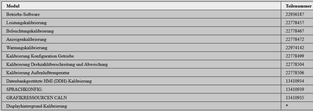

In the first file your adapter hasn't found the IPC before readout.
The programming process was interrupted in the second file (timeout during seed request).
The calibration numbers are matching (despite the warnings calibration), have you tried it again, or do you have access to another J2534 device?
