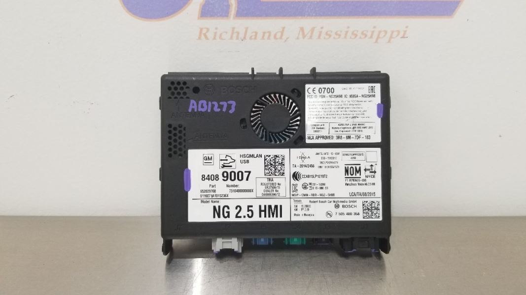

Hello. Updated HMI from 2.0 to 2.5. sn 84089007) Now the question is where to find calibrations?

U have to use donor VIN, as your is 2015 and is not intended to have HMI 2.5 and there is no calibrations for it. Or u can state what is your extras (camera, touchpad, etc.) and may there is package made by @Troy where can use it.
I understand that there are no calibrations for 2015. Could you download calibrations for a car with 2G4GM5EX5H9155534 ?
they are individual paid files. As well, your part number is not listen under other VIN, best solution is to use HMI donor VIN.

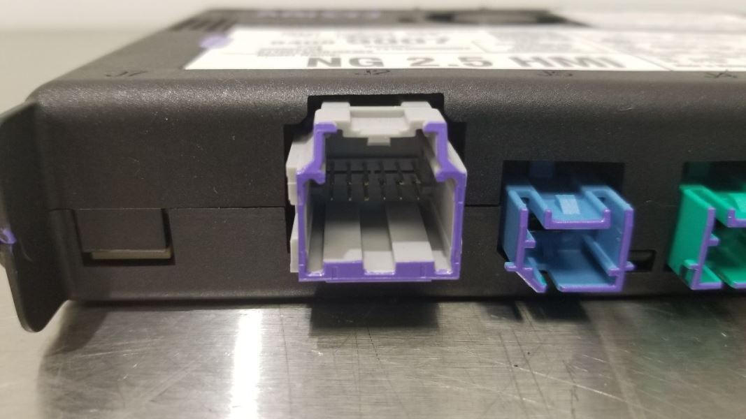

the VINs you shared, don have Integrated navigation and the hmi 9007 dont have the blue plug for GPS antenna.
