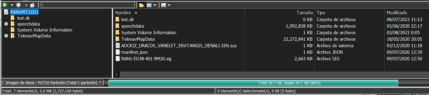

i buyed a SD with maps from USA, and i have a img of european maps... (but this image has been taken after activate the SD onto the radio)
i think the unused (NEW) cards dont have CID, and in the first use the radio writes the CID onto the SD... but im not sure of this.
when i receive the USA SD card i can do tests.
