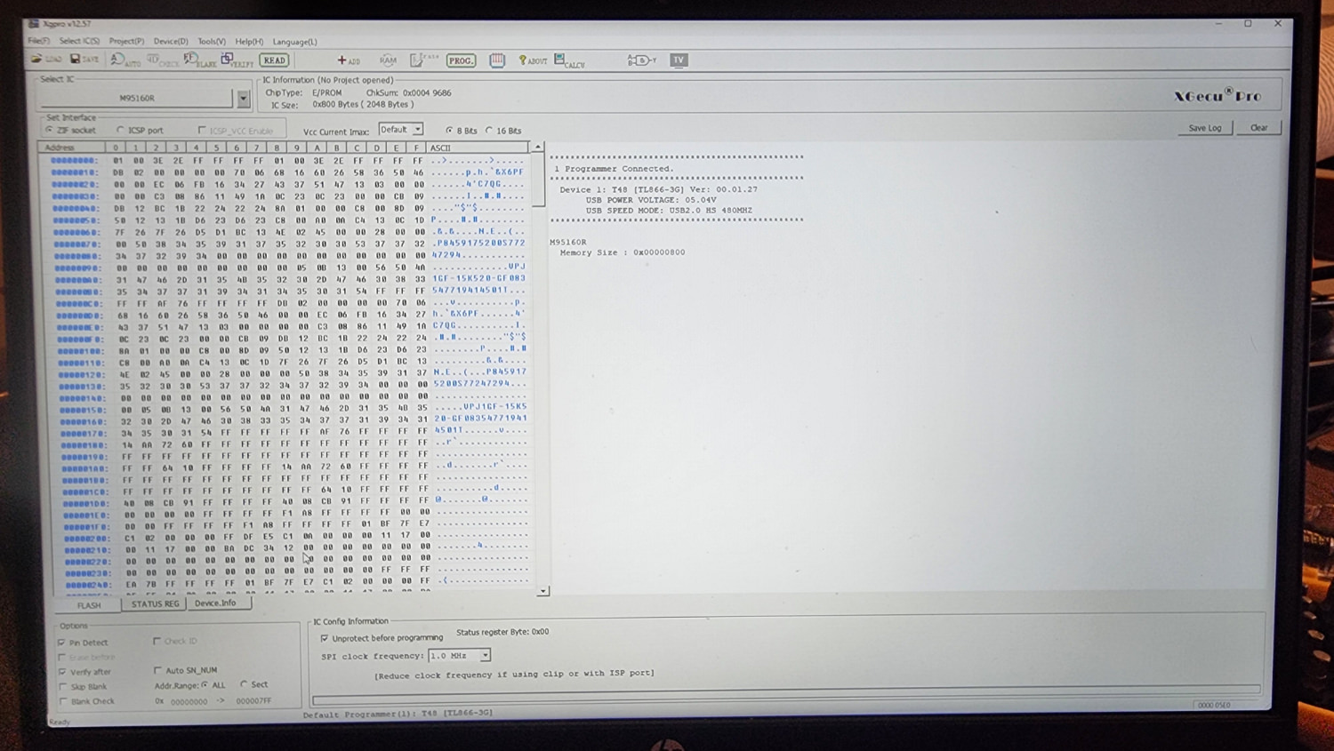

Its the 8in IPC, trying to select the correct ID chip to read the data so I can change the VIN and PIN for my 2019 Chevrolet Traverse.
The one printed numbers it has are 16H 9017.
As for hardware I'm using is a XGecu T48 with its software Xgpro v12.57 with the adapter and clamp so I don't have to remove the chip from the board.

Yes, your photo shows the correct EPROM chip. However, it seems GM used an OEM EPROM chip that doesn't have a trackable part number on your board.
The 8-inch IPC from the insignia has the same layout circuit board. So I assume the EPROM chip that's used in the insignia board could be the same as yours.
You can try using this part number from the insignia to read your EPROM chip."ST 95160RT or ST 95160

Thanks Troy,
I did follow that specific thread to finding the chip which I figured it should be the same. Let me try to read it with selection and see if I get the data out of it.

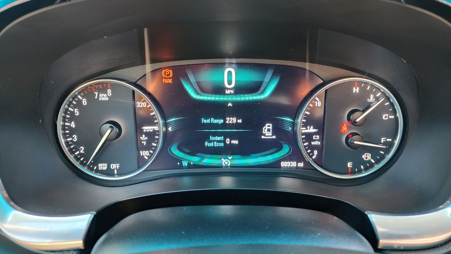

Got in displaying the milage on it. Changed the VIN but not the PIN. I thought I had the card somewhere when I bought my Traverse but couldn't find it.
Will leave it as is for now. Need to figure out how to enable the transmission temp gauge, get the PRNDL to display next to the compass and have a Service Adaptive Cruise Control so my foward collision ain't working. But willing to add the module once i get ahold of one so no biggie.
