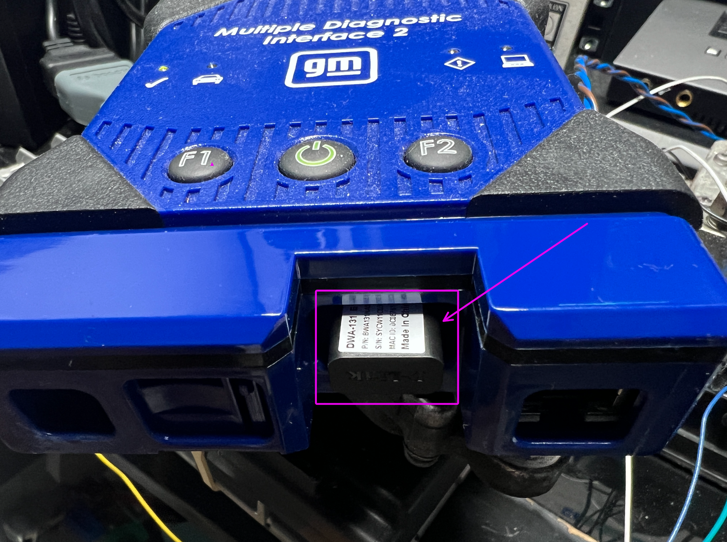

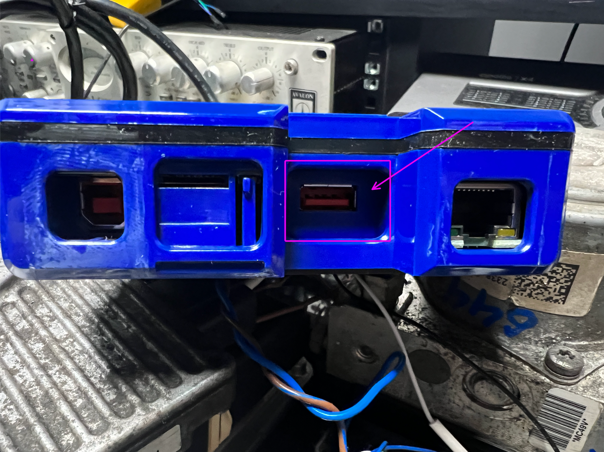

  • On the MDI2, you can remove the rubber enclosure and then unplug the USB D-Link WIFI dongle to disable the WIFI.

I have confirmed it is this MDI2, my MDI1 does not cause interference. I think it is where to 2 has Wi-Fi integrated. I was wondering if there was a way to disable the Wi-Fi option to keep it from dragging my network down.
Simple enough! Thanks Troy
