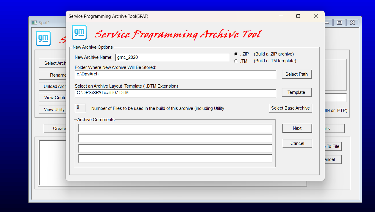

Please enter packaging namegmc_2020
<< automatic input 1 >>
<< tisweb input 2 >>
<< SPSToolBridge input 3 >>
1

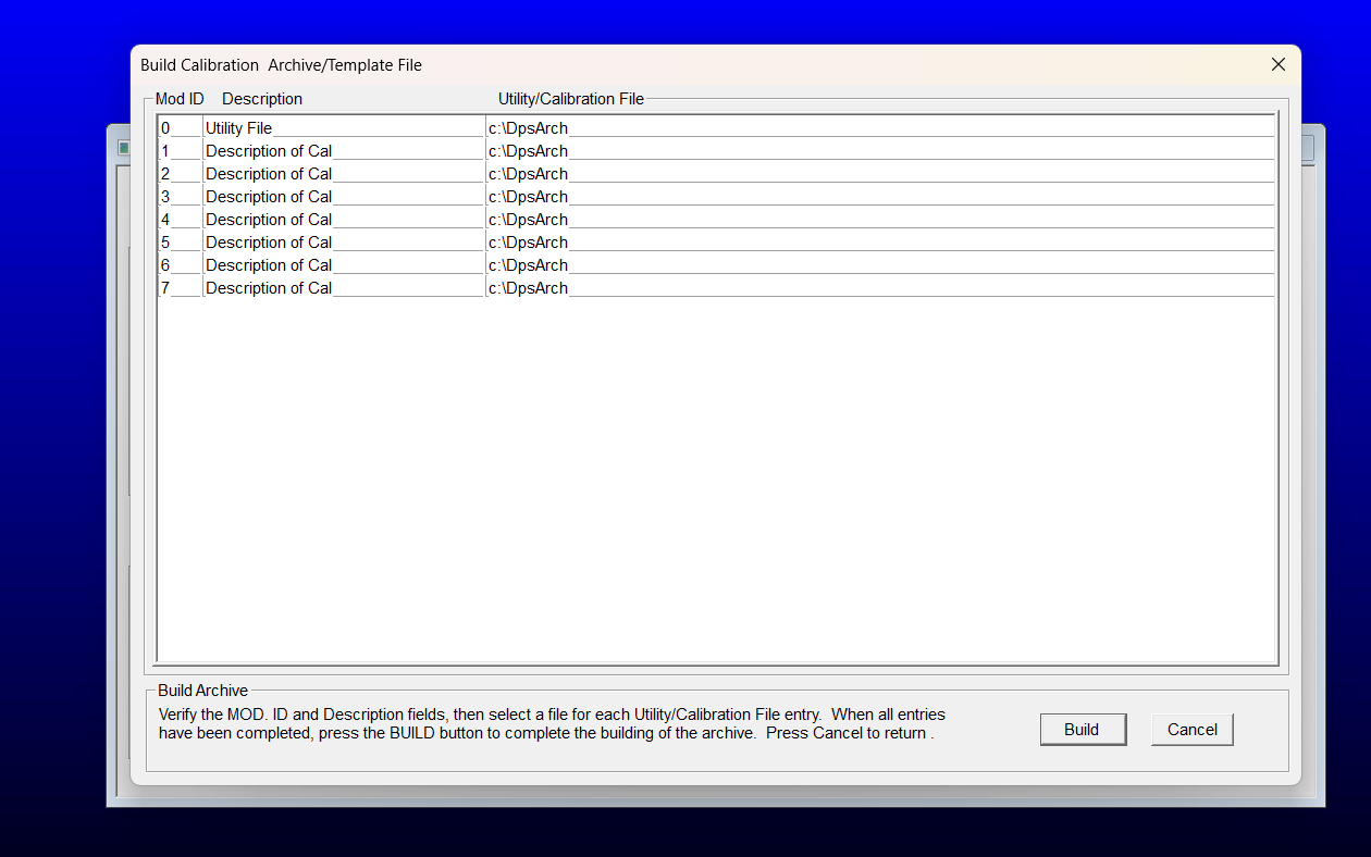

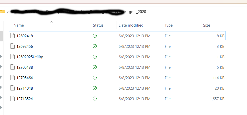

Have you tried to manually create the ecm dps archive for the ecm files that has the issue?
share calibrations and ECM info
Unzip calibration files and try to create dps archive.
Yes, but the same problem

gmc_2020.zip
i try the same problem

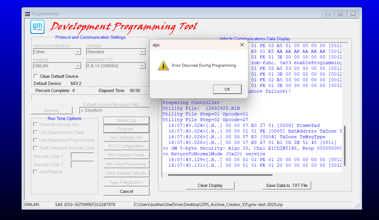

Update I tried that I got a wrong message
7 hours ago, Lyubomir Krastanov said:
try this, I cannot test as not have emulator or this type of vehicle
I think the problem is in
>> GM 5-byte Security: Algo 28, Chal B18352ED48, Resp 0000000000 >> Status Denied

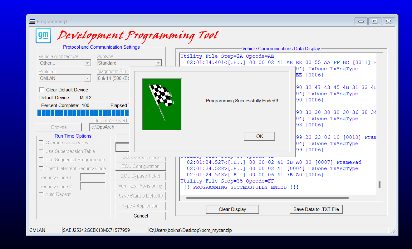

This is another E90 ECM
Programming completed successfully
>> GM 5-byte Security: Algo 28, Chal EB70D31306, Resp 830DC7789F >> Status Success

Is it possible one of ecu to be locked. I wait friend of mine to share with me 5byte seed calculator, so can try to calculate response and input manually prior programming

I create file manually. And try to flash ecu first on sps then to flash on dos. May be HoT unlock mess up something. Never use these.
