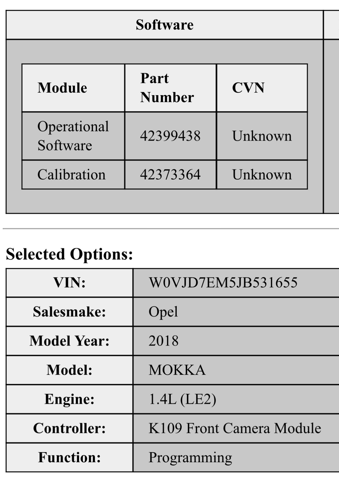

Hello, I am looking for the front camera Mokka  W0VJD7EM5JB531655 calibration file " 42399438 and
42373364" I want to enable UVX. Maybe who has?

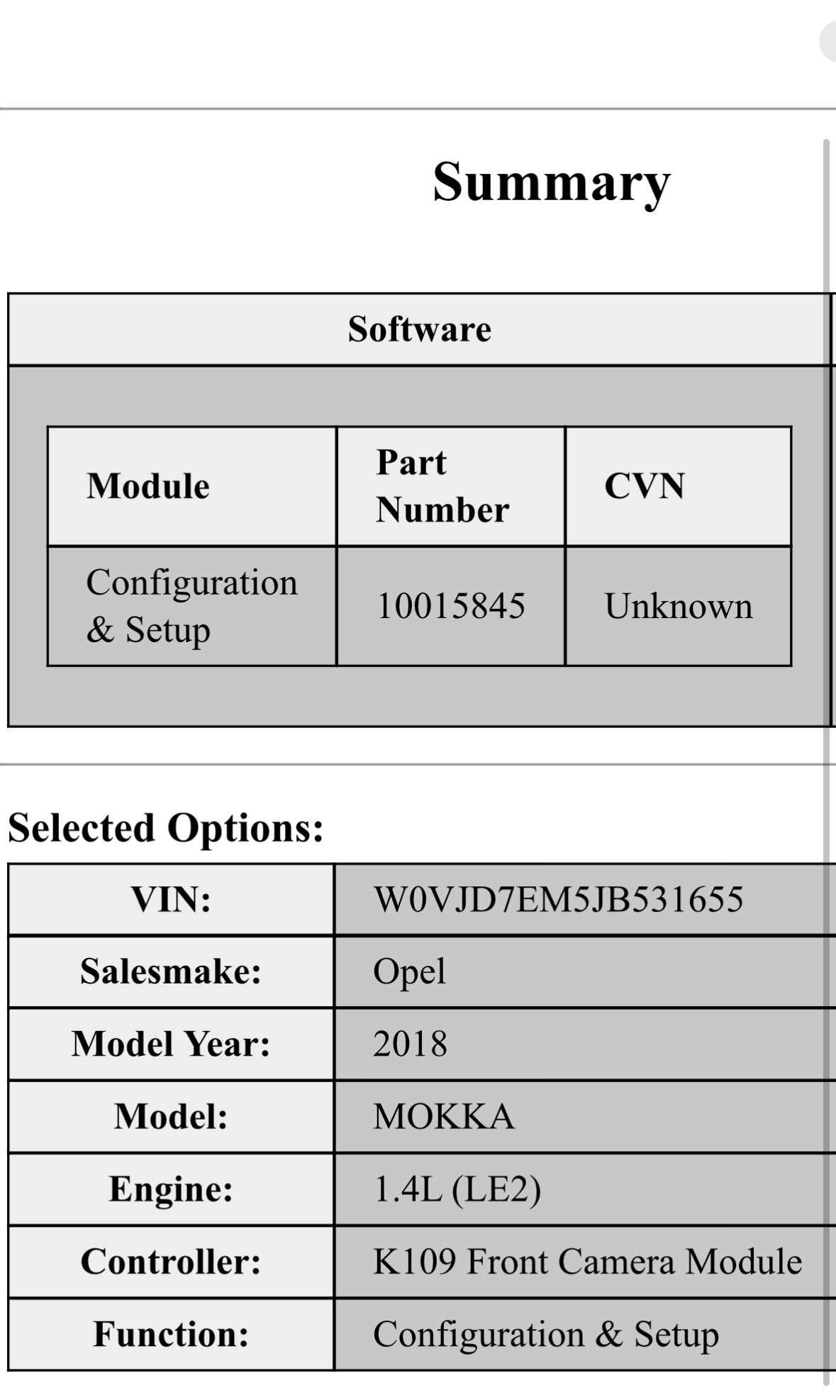

Will try to download them later. As well and Setup files.
If you have GDS or DPS can you read camera and give me screenshot from Identification page. Need to know base model number
Base model number 42399437
Will try to emulate this module later today or weekend. Not guarantee will success.
