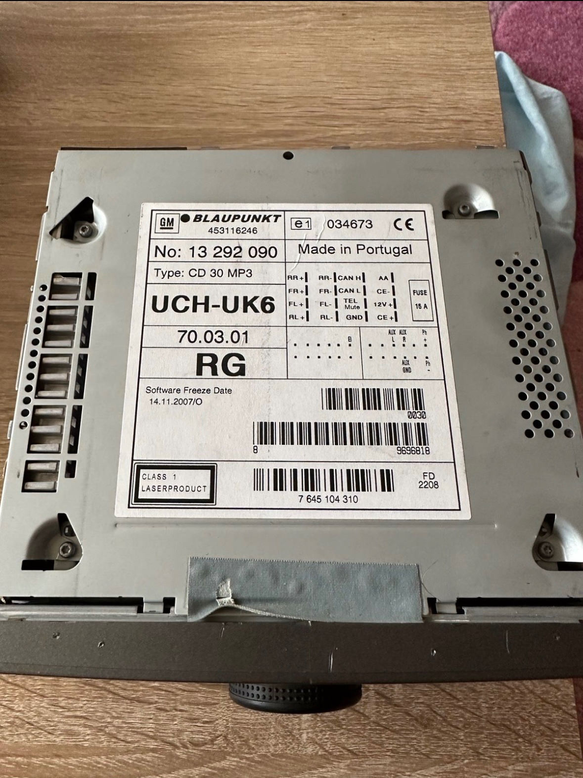

Hello friends,
 I have a used CD30MP3 which I can't get reset I got the security code from the eeprom it should be 0014 unfortunately I can't deregister the old CD 30 because it no longer exists does anyone have a suitable eeprom where the radio is reset? or can check if the code is correct
 I thank you in advance

I have it with MDI Tech2Win, Op Com Version E , and with an AutoScannerOpelCAN. tried
Unfortunately, about 9 years ago, I removed the correct CD 30 and exchanged it for a DIN1 radio, and forgot to reset the radio and display. I sold the old radio years ago. Now I have the problem that I can't get the TID reset.

what is the TID code, do you mean the code from the car? Ig also have it ab3r the TID is logged off via the radio and if the radio does not match the car it unfortunately does not work, so I try to reset the radio via the Eeprom
if the tid is the original of your car, the TID have the code of your car.
For correct pairing, the mid speed can bus must be the same in all units, and the security timer should be stopped. you can check this using opcom, in the Measuring Blocks
the radio dump i atached before, is the radio in delivery mode.

 With your eeprom it worked, I was able to successfully register the radio with the car. Thank you very much
