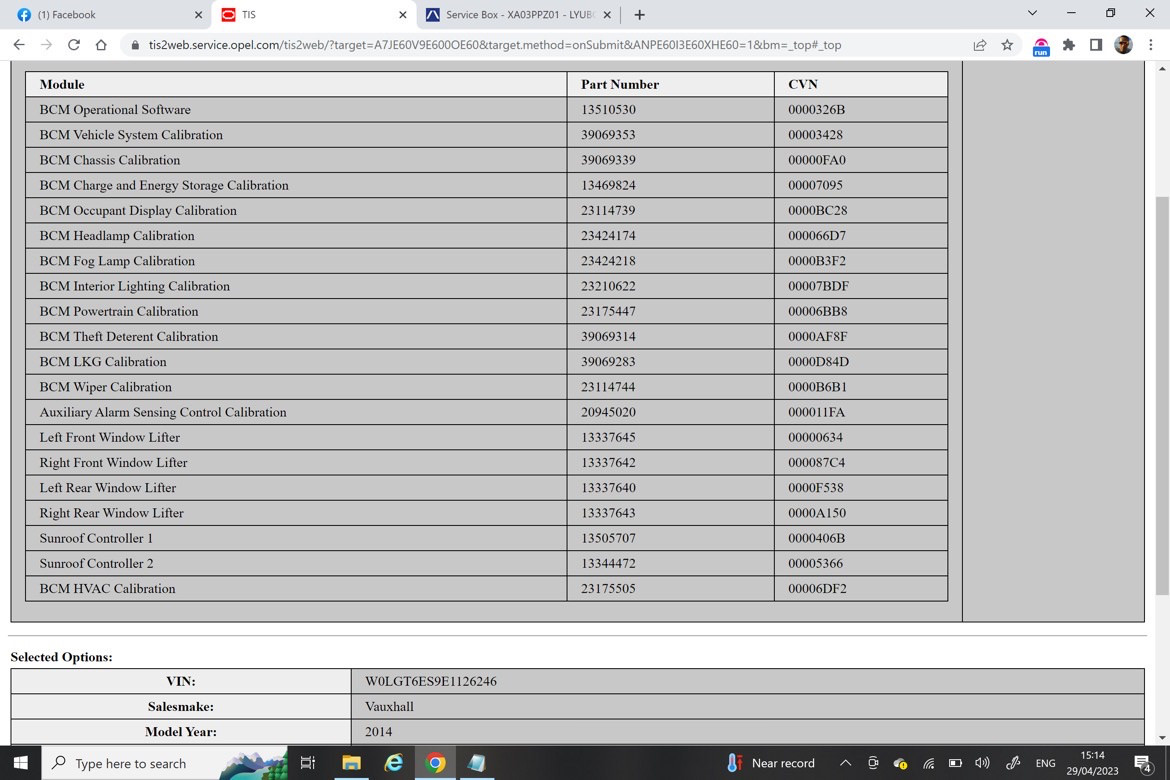

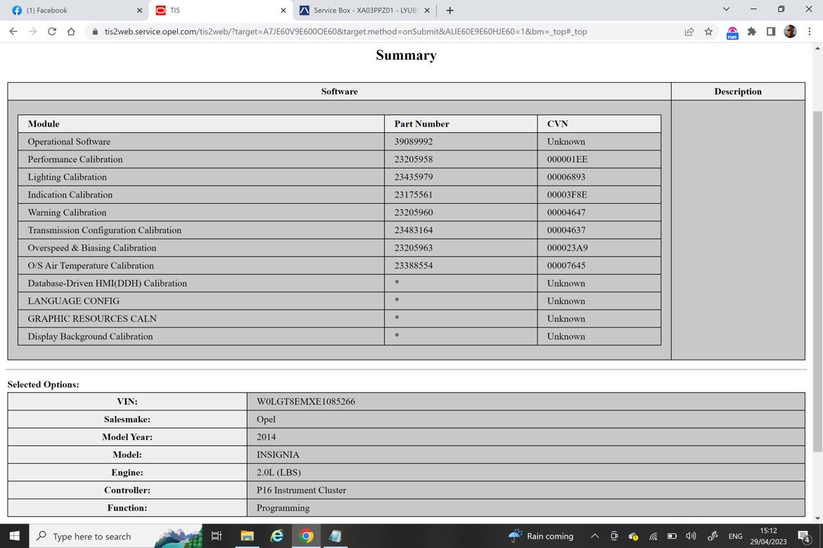

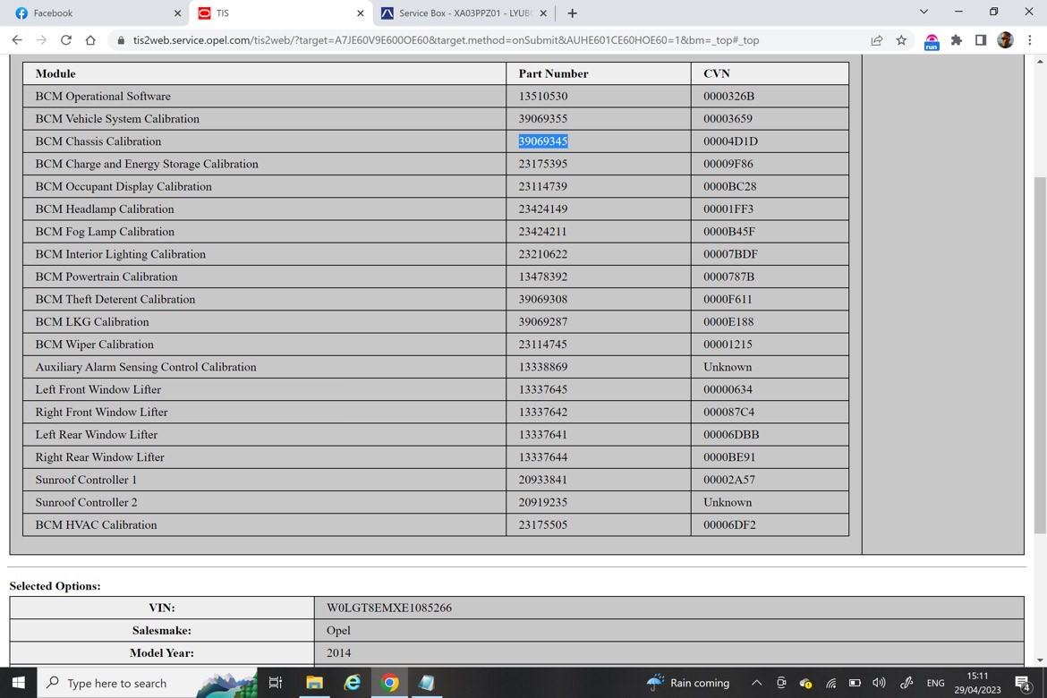

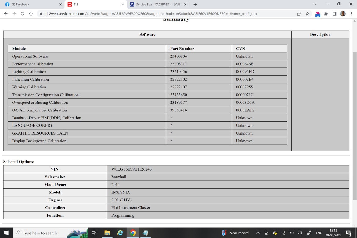

Out of interest if someone can give me some advice. Have friend with facelift Insignia 2014 without TPMS. As far as I know need to program BCM and IPC to be activated. I have calibration from my 2014 Insignia with TPMS, can I swap him files for BCM and IPC with mine and make DPS package? Think for BCM need Chassis calibration and for IPC need warning calibrations. IMG_0639.jpeg.a1cd990fcb769fc7f0af9a857f33e4c1.jpegIMG_0636.jpeg.06c7b0d104b77ea0559013dccd3442be.jpegIMG_0638.jpeg.f3f9ee9e5028d91e32abaf4cd9633009.jpegIMG_0637.jpeg.cd3ced2d7b2cebc963b10e1bdeb4c44a.jpeg
There's definitely 2 calibrations needed by the IPC for TPMS to function, You'll need Overspeed and biasing + warning calibrations..
So left to mix both car calibrations and test if it work if not as last resort to pay for VCI
