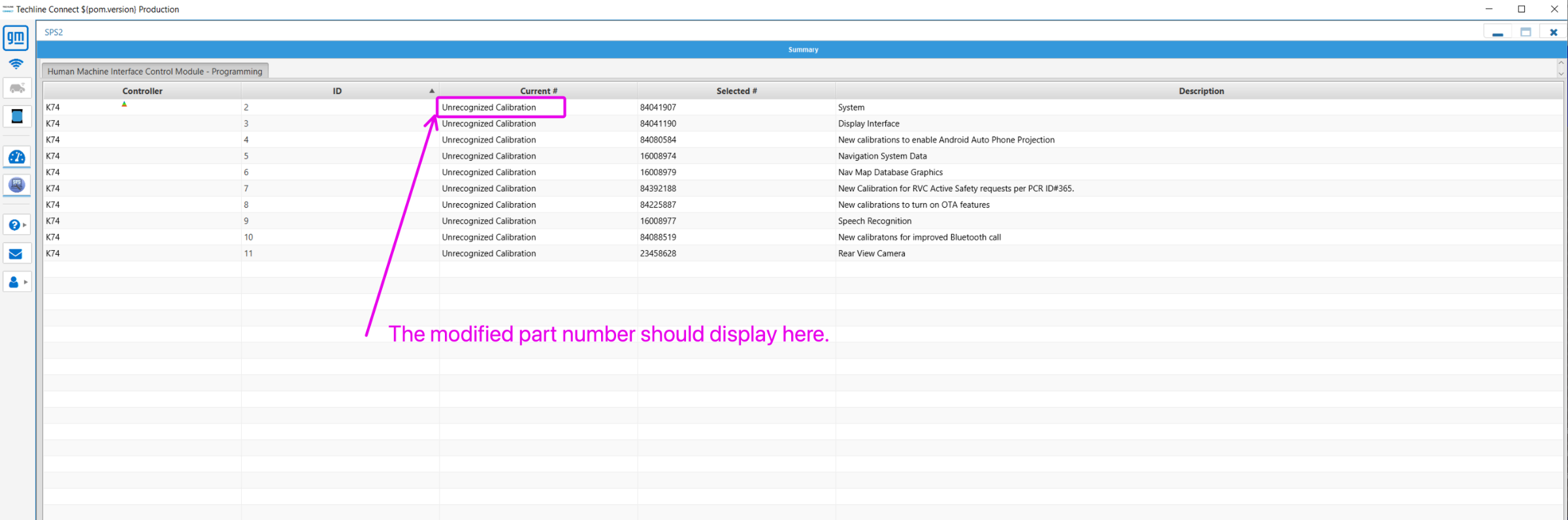

Hello. I have SPS2 error saying that I have newest files installed in module. I tried to trick SPS by changing calibration number inside file (using Troy's tutorial), but same issue. Any idea why it doesn't work?

Is the vehicle European specs? With the European models, editing the system part number should do the trick.
When you use sps to get the files, do you see the change part number listed on SPS screen under the current part number tab?
BTW, send me the VIN and the module name i'll try on my end to see if I can get those files without editing.
