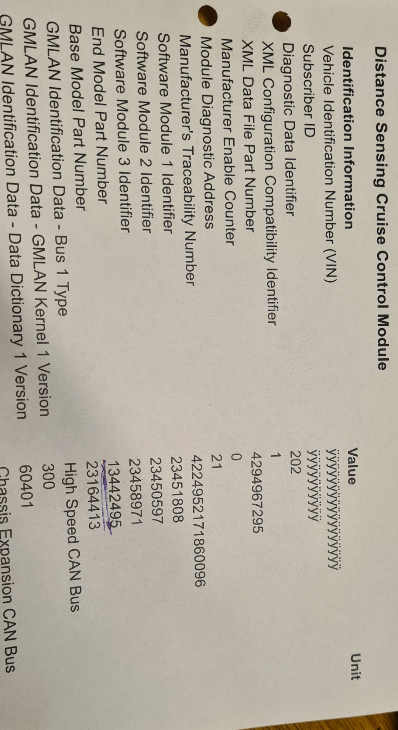

I got a Chevrolet Suburban can you help me change the vin in this module?

Hi I have tried to do this but I get error code C0565 Vehicle Identification Number and C056E VIN not Programmed. And that in the data list there is only mass YYYY instead of Vin no.
