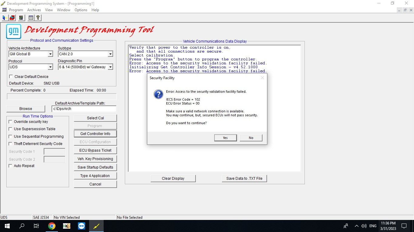

Since its Global B , DPS 4.52 return error and need access to security validation facility
I think, first of all we should understand list of ECUs set DTCs: lost communication with ALC or something like this
