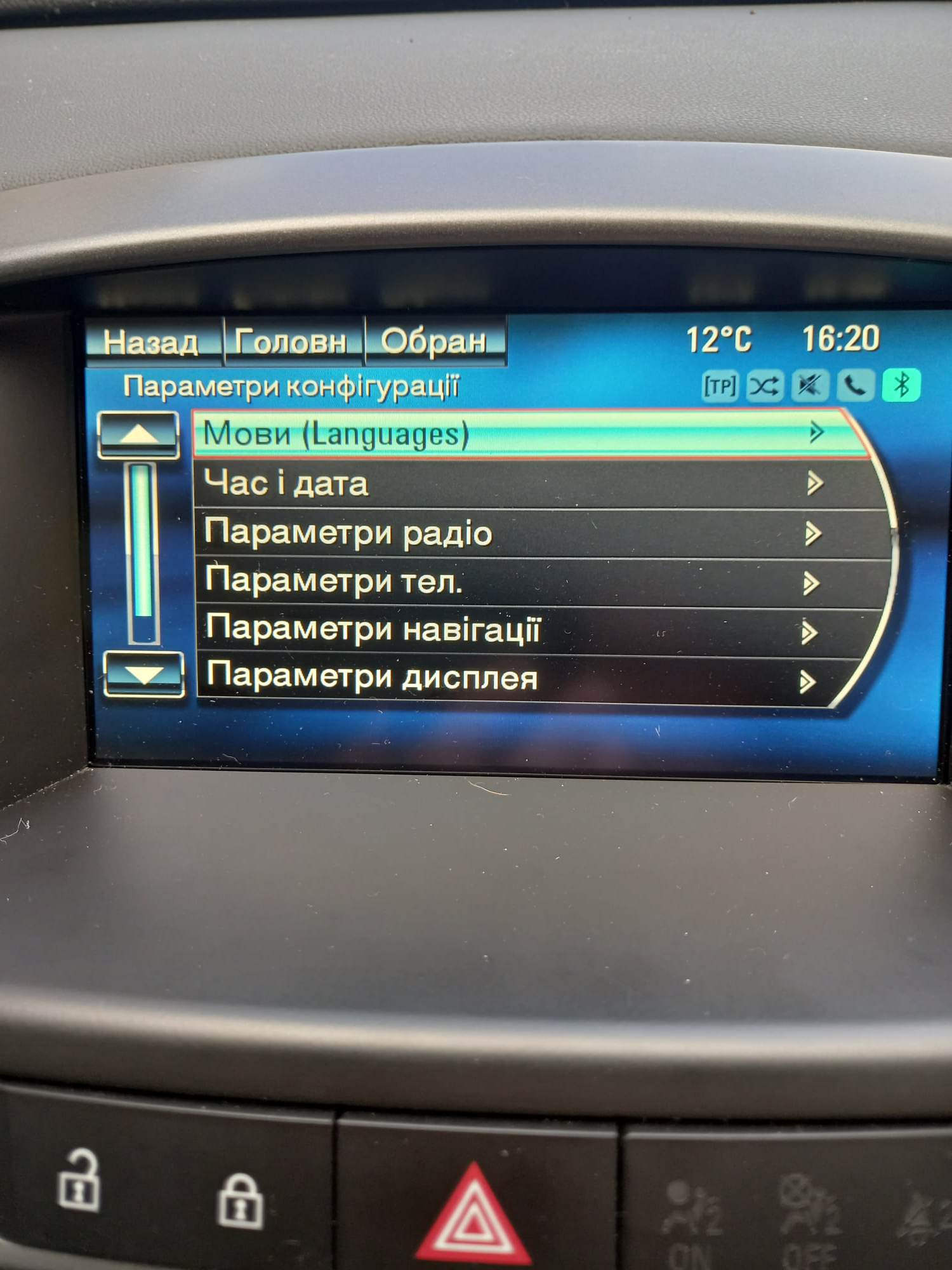

    Result is after a late night I can now read fluently "Service Airbag" in 18 different languages.. just not yours yet 🤣 I'll have another look after the weekend when I have more time..

    Still unsure of this also... I've not received a vin or any calibrations for it yet so upto now just been experimenting / learning with the 2014 Malibu radio files I do have..

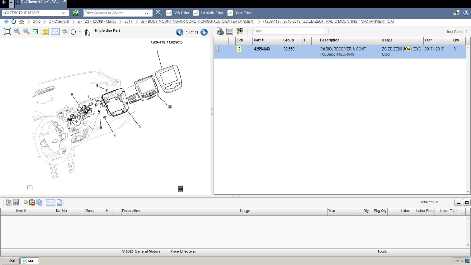

    Malibu doesn't have HMI Correct option is IOA   I can check calfile for language later

Chevrolet MyLink™ with 7-inch Diagonal Color Touch-Screen Display — RPO IO1

Thanks to @DarkDiver sending over his original calibration to compare I've found it on mine.. should be a 2 min job now when we have the files.. are we changing to EU frequencies at the same time..😉😁..?

Have my vote...  after seeing Maxim's 3kb language file it doesn't compare to my 1kb file.. The rpo list for European vin W0V7H9EB0J4322577 shows a radio with rpo IOA if that can be used to get him some files...
