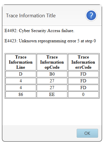

Morning everyone, this is what i got it almost feels like the hardware is not compatible i can reprogram with original calibration but cant reprogram with the 2019 calibration

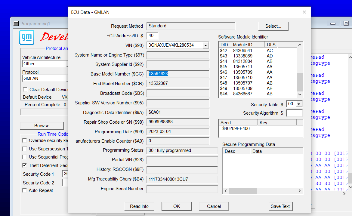

Extra info:
VIN OF THE NEW VEHICLE: 3GNAXUEV4KL288534 2019 Equinox
VIN OF THE OLD VEHICLE: 3GNAXHEV6JS574445 2018 Equinox
PIN OF THE NEW VEHICLE: 3627
PIN OF THE OLD VEHICLE: 7473
5 Bytes SEED: 46 26 9E F4 06
Key: 02 3A 09 AA 52

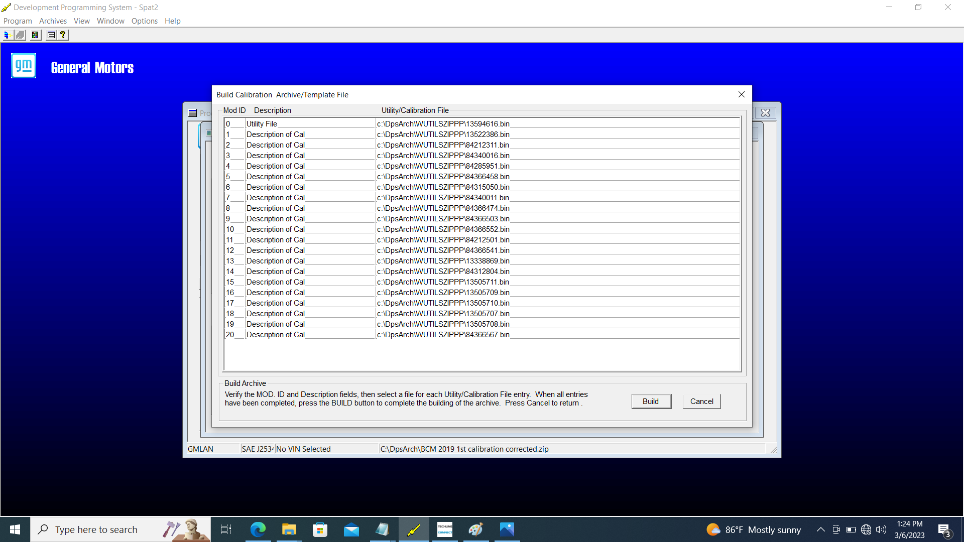

this is the 2019 calibration
this is the 2018 calibration files

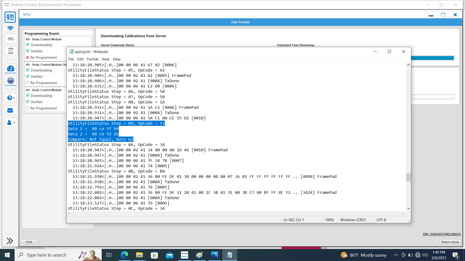

i found this comparison in the log
It is OK. DPC compares current version of OpSW and new.
