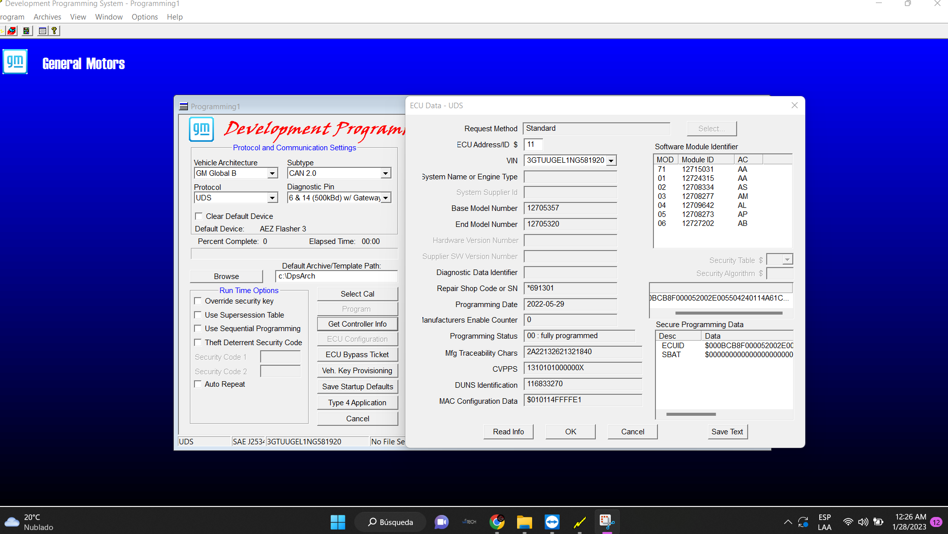

I have some Global-B modules on the way, I need to know if I can connect a Global-B BCM direct to the power and Canbus data line and have DPS read the VIN, or will I need to route the BCM through another module in order to read the Global-B VIN with DPS?
Will need the Network Gateway Control Module for connecting to DPS?
  • Views 1.1k
I directly connected the pcm without GATEWAY and managed to get the SEED reading using DPS.
no need gateway for connection
