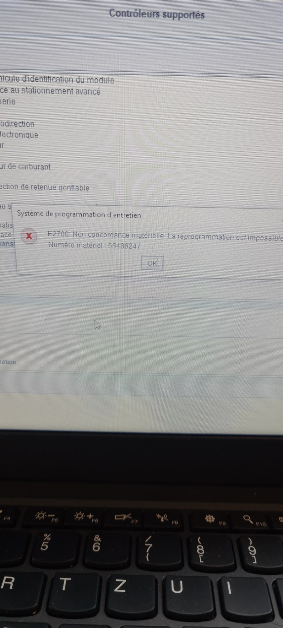

Ok, but if the vin has  been changed could  I reprogram and adapt it by sps?

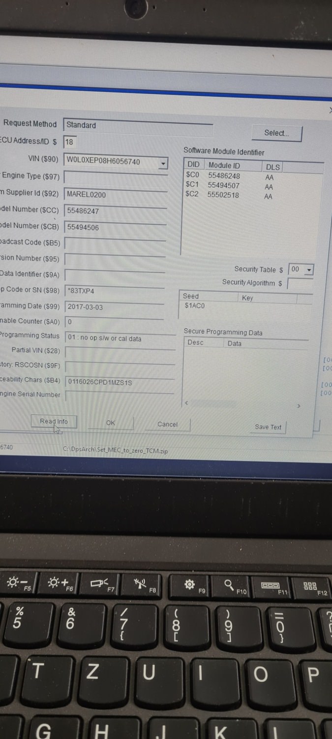

20221013_105741.thumb.jpg.87c39c2ce9bec3e8ce3e38b73270b7ff.jpg... and how can I get  utility file, sps doesnt want to program any file to this module?
or may be this module is incompatible to this car
Try using the vin that’s stored in the used module in sps when programming. Maybe sps does not have that part number listed as the one for your current vin.

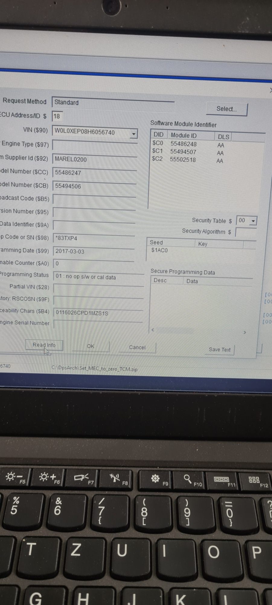

I menaged to communicate with ori module, will try to make calibracion files and to progam the new one, by your advice

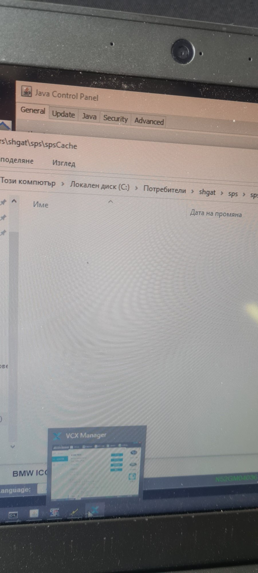

Hi why my spscache folder is empty?

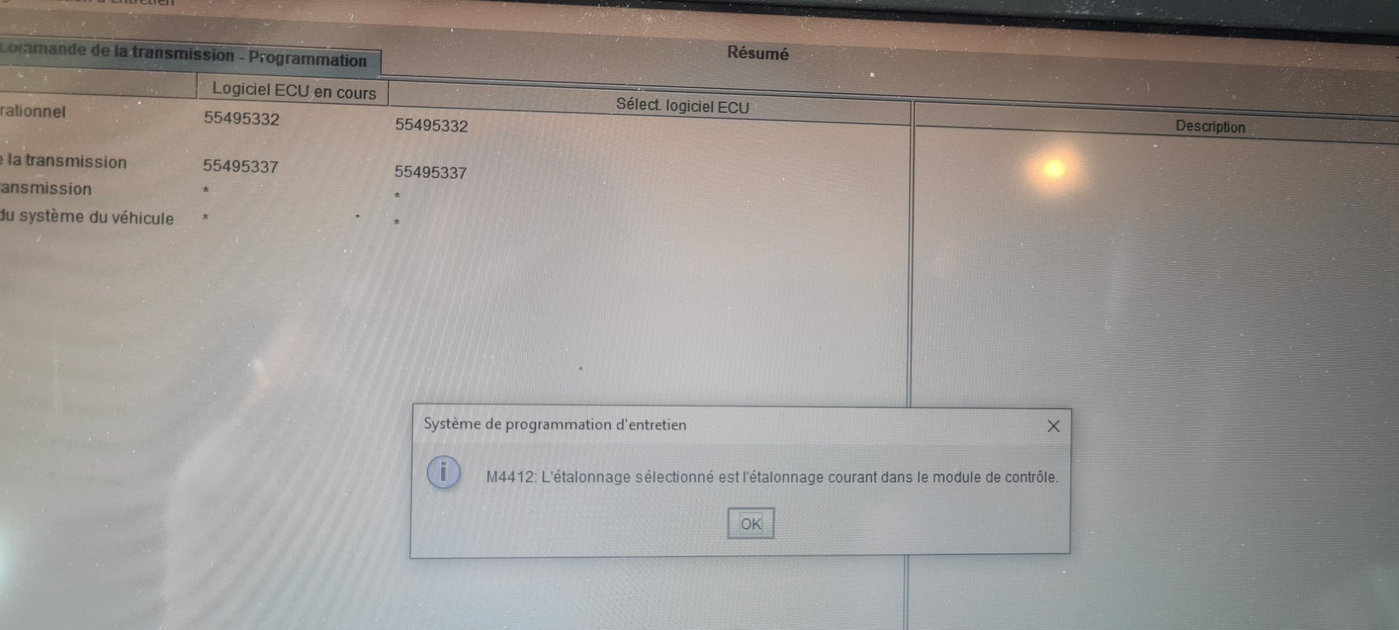

Sps says that the software is the same
