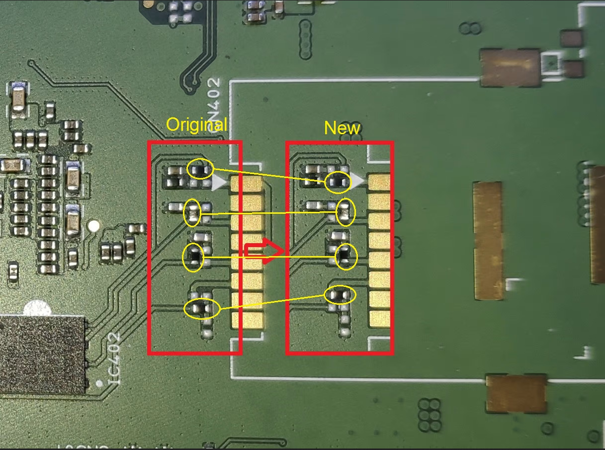

I wrote a small instruction on how to get the 4G LTE Internet in a Bolt.
maybe someone want or can try to do this mod.
This no enable the onstar service again, only enables the wifi hotspot with any sim.

I no have success to make it work. Have soldered al as is, but there no service. Look like I’m missing some calibrations before OTA deactivation

The hotspot can be enabled using a bin with DPS....
My wifi hotspot is active and working, is visible from my phone and I can connect it. Isssue is where blown internal error and doesn’t see sim card
