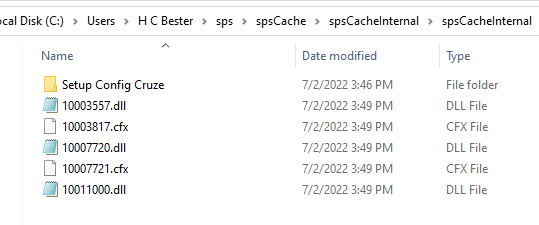

On SPS if I do s Setup & Configuration on the TCM , I get the Cache files in the Dir, and Build files in Type 4 Dir.
image.png.dedce1b12fe95038eb53dcb49db15b74.pngimage.png.ad79cd3de79d793773df1012903e38de.png
Those files won't help. You could try edit calibration files and change the hardware id, but you will need a set of calibration files to do that with dps.

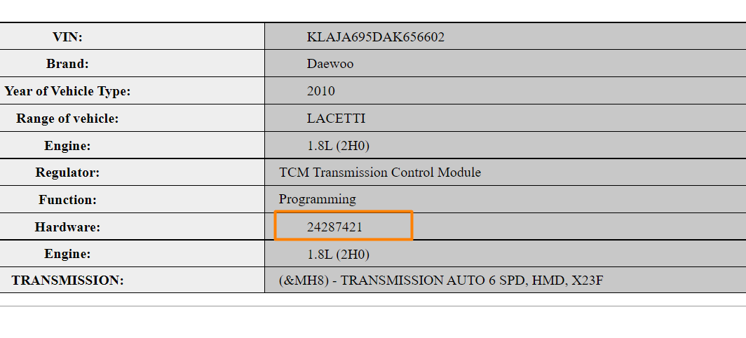

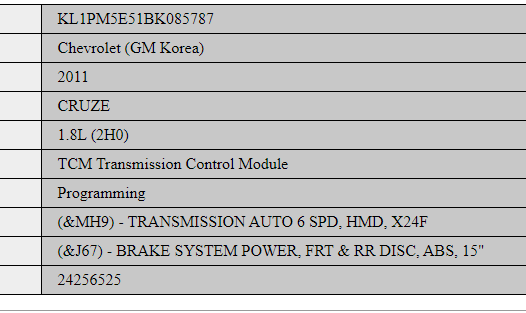

Can you show VIN of Daewoo Lacetti 1.8 And VIN of Cruze 1.8?

2010 Lacetti VIN: KLAJA695DAK656602
2011 CRUZE   VIN: KL1PM5E51BK085787
I don't know your hardware TCM. So I can not to get file BIN
