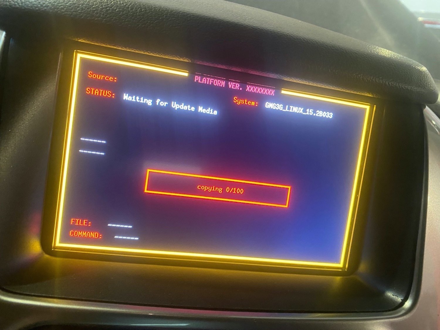

Hello! I need some help with car Chevrolet Tahoe 2018 6.2. HMI now wanted to be updated. You can nothing do.Always this picture "waitnig for update media". Tried to reprogram it by Techline but it can`t connect to it. Tried to make usb flash for it from techline, but this function does not support. Where can I get files and try to reprogramm it?

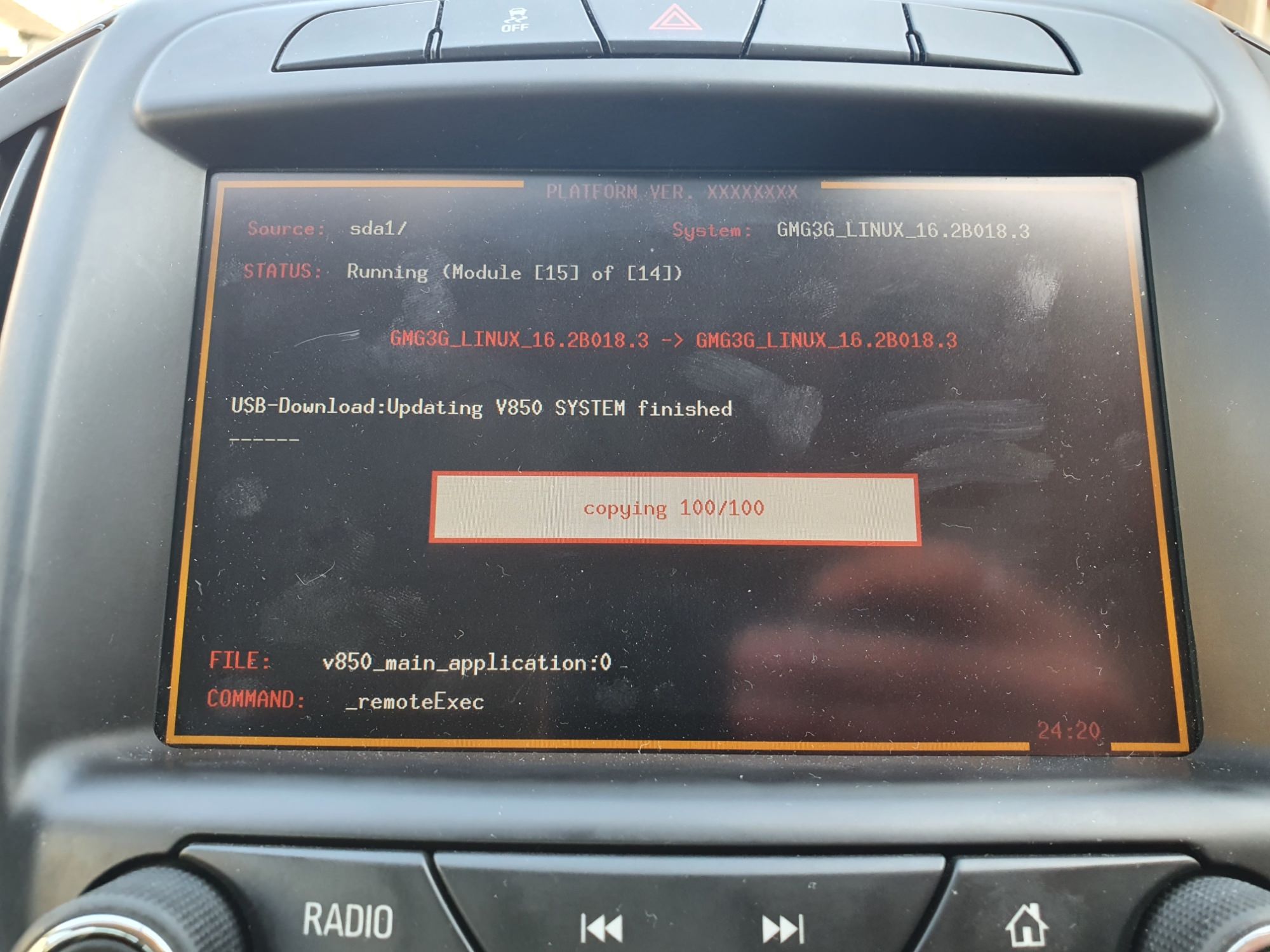

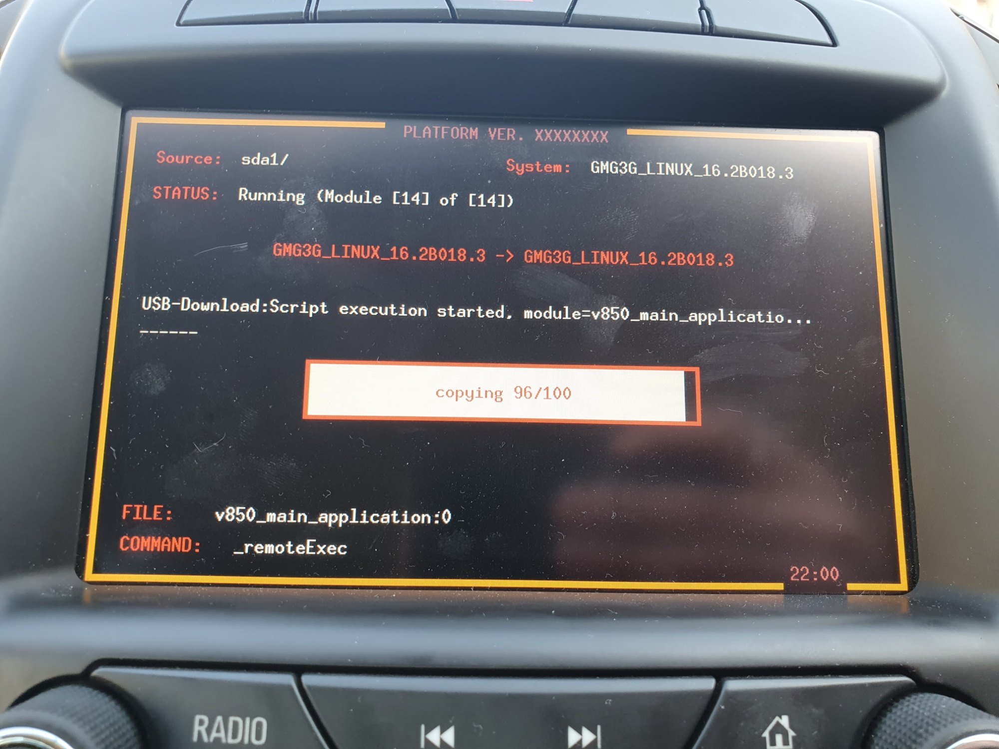

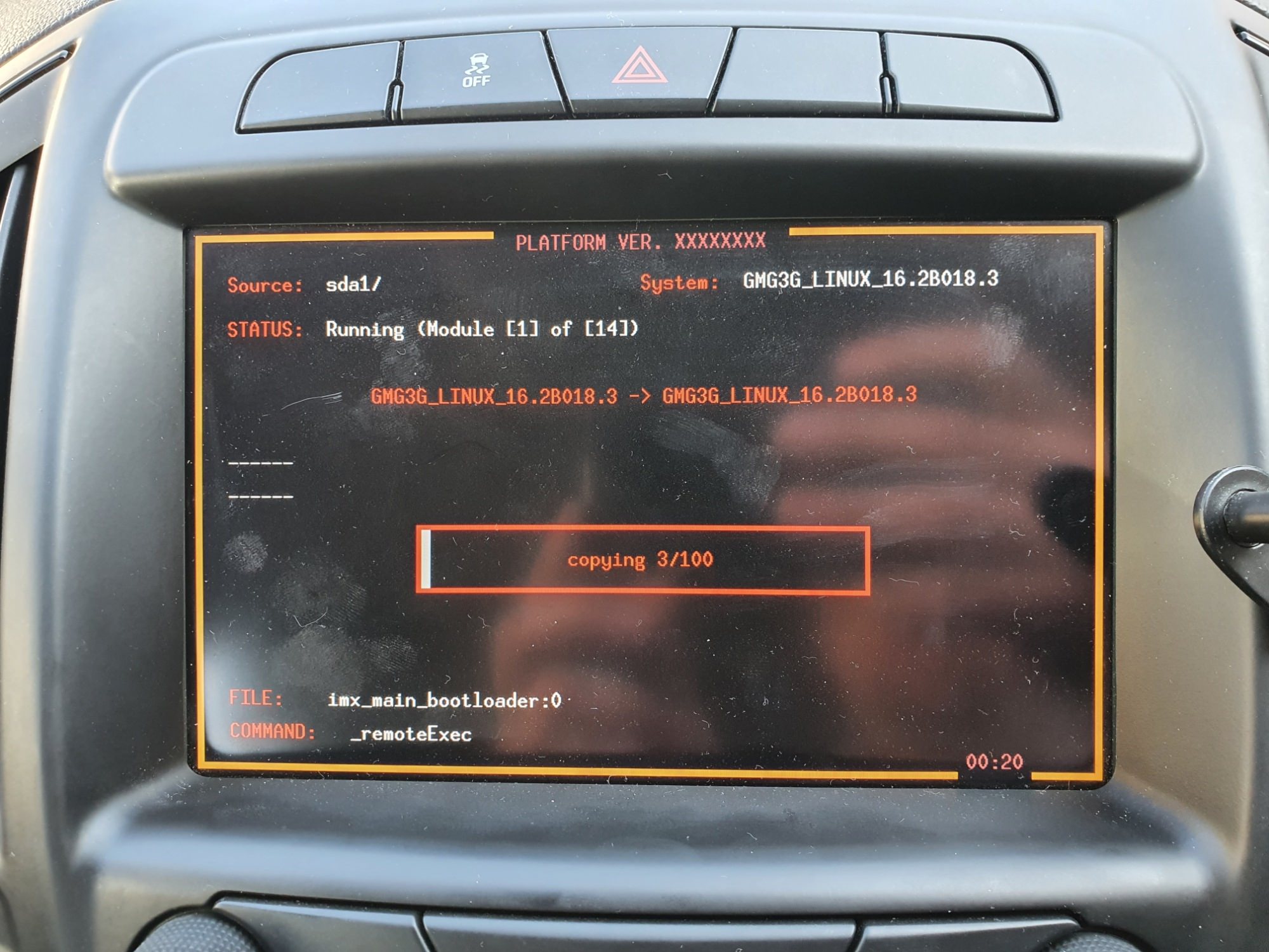

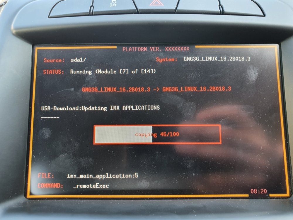

  • Hi Its happened to me, just need firmware update from USB pendrive, and all working again Sorry I have problem to upload pictures,so few links from my cloud    https://mega.nz/file/TBUU

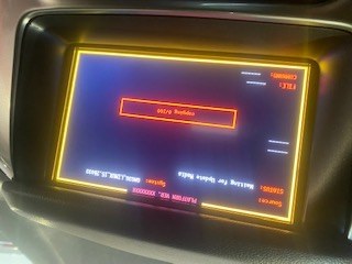

Here is just a little bit better picture. I don`t know why but picture always bottom )).  It`s not my car. They said that they disconected battery thats all. Now all the time this sign.

That's a bit strange that screen appears after a battery reboot. Thats the HMI's linux OS screen.
It usually pops up when updating maps or updating firmware.

The only way to change HMI module. You can try if the sign dissapears after 80 minutes, you can update it through GM Techline. If not, you will need to change whole module

The firmware is for all vehicles that uses the HMI 2.5 modules. After doing the firmware update you will see Calibrate Device on the screen. You use SPS to program the HMI to get it working again.

I received the file and connected the USB, but the message "Update file is invalid" appears. What should I do in this case?
84156702.mnf
Either your hardware is not supported with this update, or you haven't transferred all the files, or they got corrupted when copying.

Did you end up figuring this out? I know if you plug in a firmware USB update in at this screen to the USB port it will make this work again. It will display as Cadillac after and all the ICONs are Cadillac. You will need to program with TIS or with DPS to get your correct calibrations in to the HMI. You can purposely get to that screen by touching the reset pin i believe to ground while booting up the HMI. It will force this screen to pop up when the HMI isn't dead on bad firmware update. You can also Serial into the file system of the HMI also this way. I've had changed the splash screen to a FSU football game touchdown run when booting up the HMI in a Silverado LOL. You also can change from US to EU or ME or AU doing this also. But the correct calibrations need to be programmed to the HMI for this to work. Haven't done it in a long time. Anyways hope you got it working. I am currently looking for the latest USB Firmware Update for US. If anyone has it? Also Navigation Upgrade USB!!!!!
