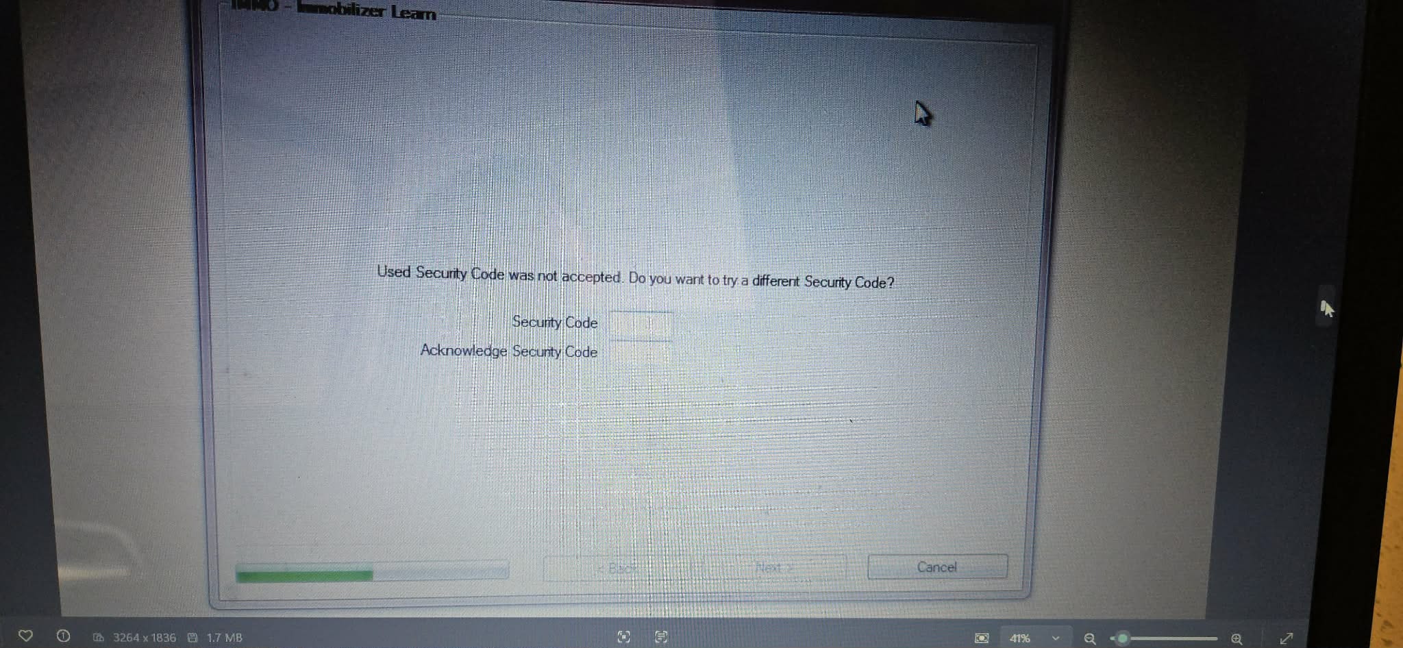

GM USED ECU ADAPTE SO VEHICULE USING THIS PROCESS SEE PICTURE
Needs Reply First Post
IN A 24C16 THAT i REMOVE from the board TO BE ABLE TO READ IT
PROPERLY AND THE LOCATION OF THAT SEED WAS ON LOCATION 8A 8B 8C 8D
31 33 36 37 = 1367
I WAS ABLE TO ADAPT MANY ((USED ECU)) LIKE ECM BCM EPS ABS BY OPENING THAT WINDOWS , THE SYSTEM CLEAR ALL THE SECURITY IMO KEY AND ADAPT THEM TOGETHER
