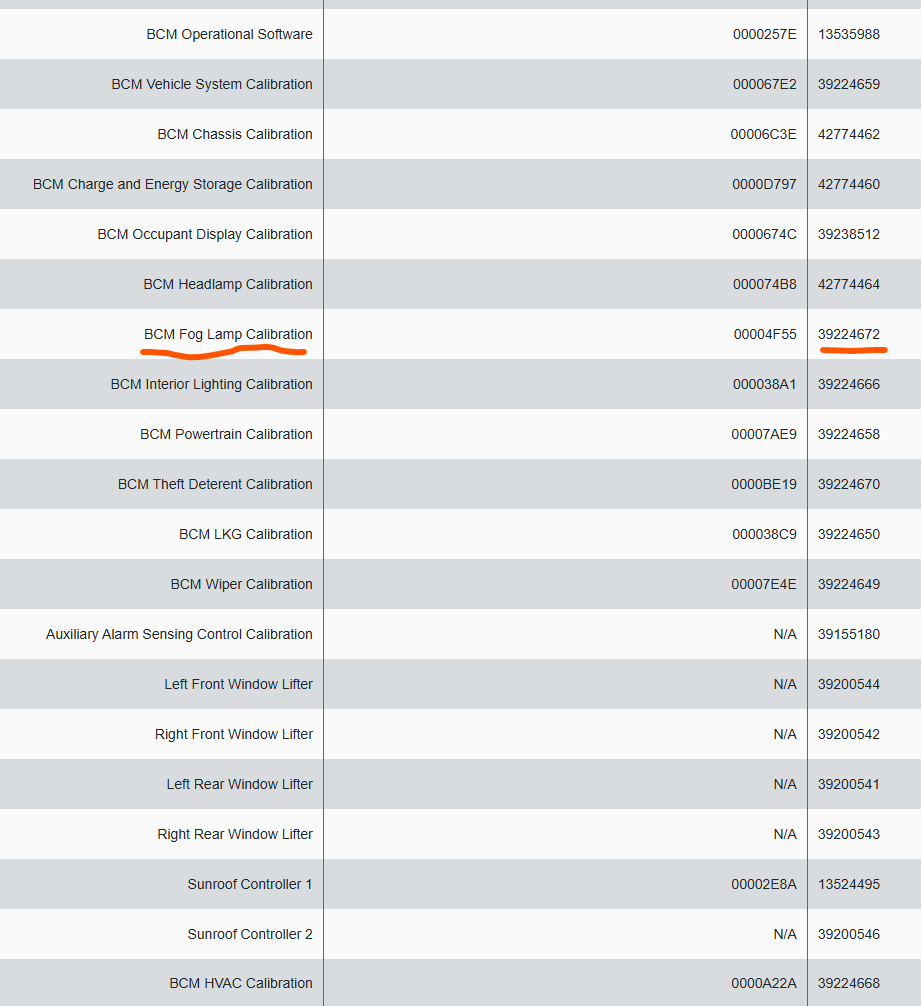

Hi. I don't have BCM cals from chinese Regal. But I can find chinese VIN and check cals in TIS.
You need to use this one calibration:
If you need VIN and you can download calibrations for it I can send it to you.
Try recording with this calibration. If the check is disabled, you can use the process of elimination to find the specific "01 01" values that need to be replaced with "00 00." I flashed a Buick Encore about 20 times before I found the right ones that disabled the check.
