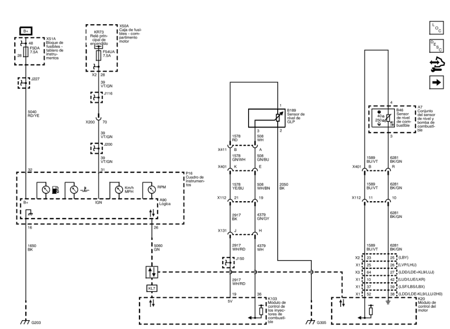

vauxhall astra j ipc 32 plug pins out wanted for cambus wires high and low needed becacuse trying to build t bench rig got the ipc to power up and got obd port cam wires just need the one for 32 pin ipc ones thanks
  • Views 216
maybe this can help
