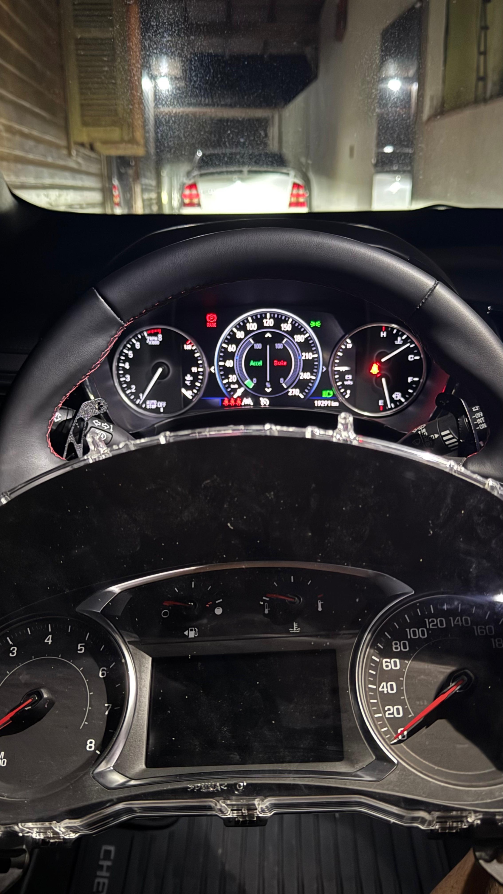

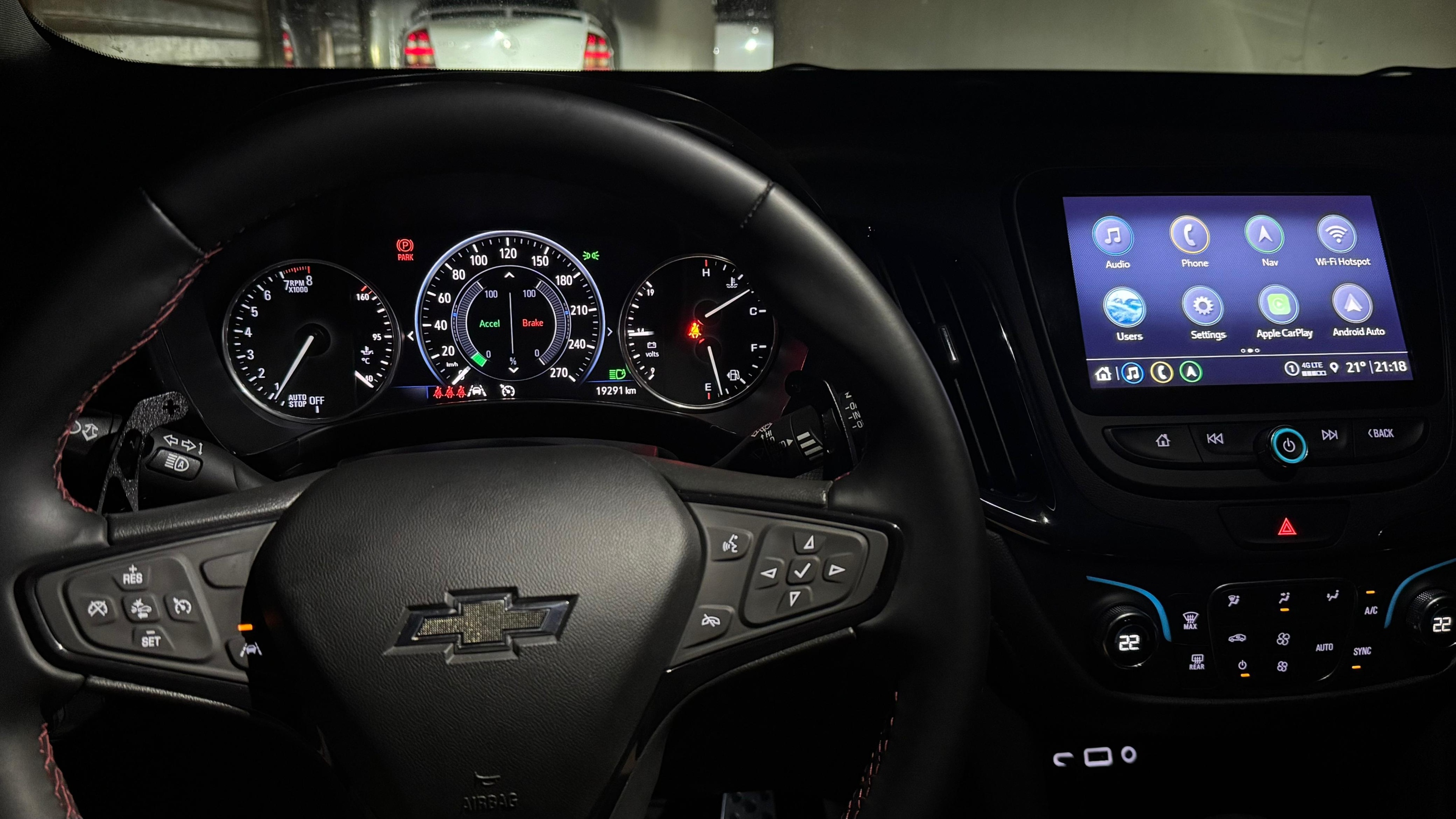

I bought a 2020 Buick Enclave cluster to install in my 2022 Chevrolet Equinox. A person from the United Kingdom did the calibration/programming for me, and technically everything turned out perfect, with a few exceptions.
The gear position does not appear on the cluster, and the oil temperature is not being read. Does anyone know why this could be happening? Could someone help me with this issue?
Everything else is working perfectly. However, one important detail is that this person from the UK programmed it using Opel Insignia software, because the Equinox never came with this cluster from the factory and he did not have GM vehicle software available. Even so, it still works perfectly apart from those issues.
If you’d like, I also have a YouTube video that I recorded showing all the functions working. https://www.youtube.com/watch?v=OPtoPcuBRSY
As you can see in the video, the gear position does not appear on the cluster, so I’m not sure what could be causing this issue. The person who programmed it for me tried every possible way to make the gear position show up on the cluster, but he was unable to get it working as well.

If the gear are not shown in speedo maybe the xml configuration its wrong
The oil temperature in some cars not works
have you the original vin of the speedo?

Do you think that maybe a 2023 Blazer RS XML would work and then start showing the gear position information? Because the Equinox and the Blazer are basically the same vehicle.
The XML configuration is very similar across different models, although the XML files themselves often have different options. If you configured it with XML, you'll likely need to include everything missing from your original XML file in the new speedometer's XML file. Trying to configure the UHS with your UDD XML file won't work.
