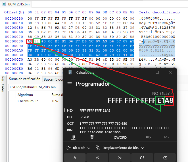

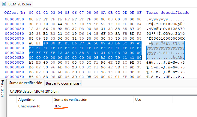

Calculating it is simple. The EEPROM is divided into 64-byte blocks where 00-01 would be the checksum, and 02-64 the data. This data includes the PIN, VIN, odometer, programmed keys, etc.
If you edit something, select the 62 bytes, and in HXD (it should be similar in the Neo hex editor) calculate the checksum-16.

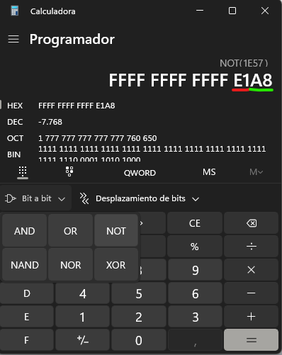

Now, go to the Windows calculator, perform a NOT operation on the value (in this case NOT 1E57),
invert the result, and that's it.
You now have the checksum.

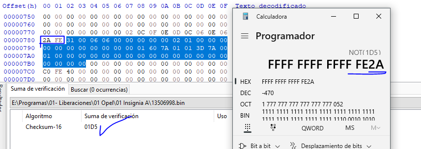

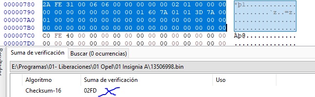

    Although the blocks are 64 bytes, the size for calculation is determined in position 02 of each 64-byte block. If calculate with all block you get wrong value: 31 byte selection:
31 byte selection:
