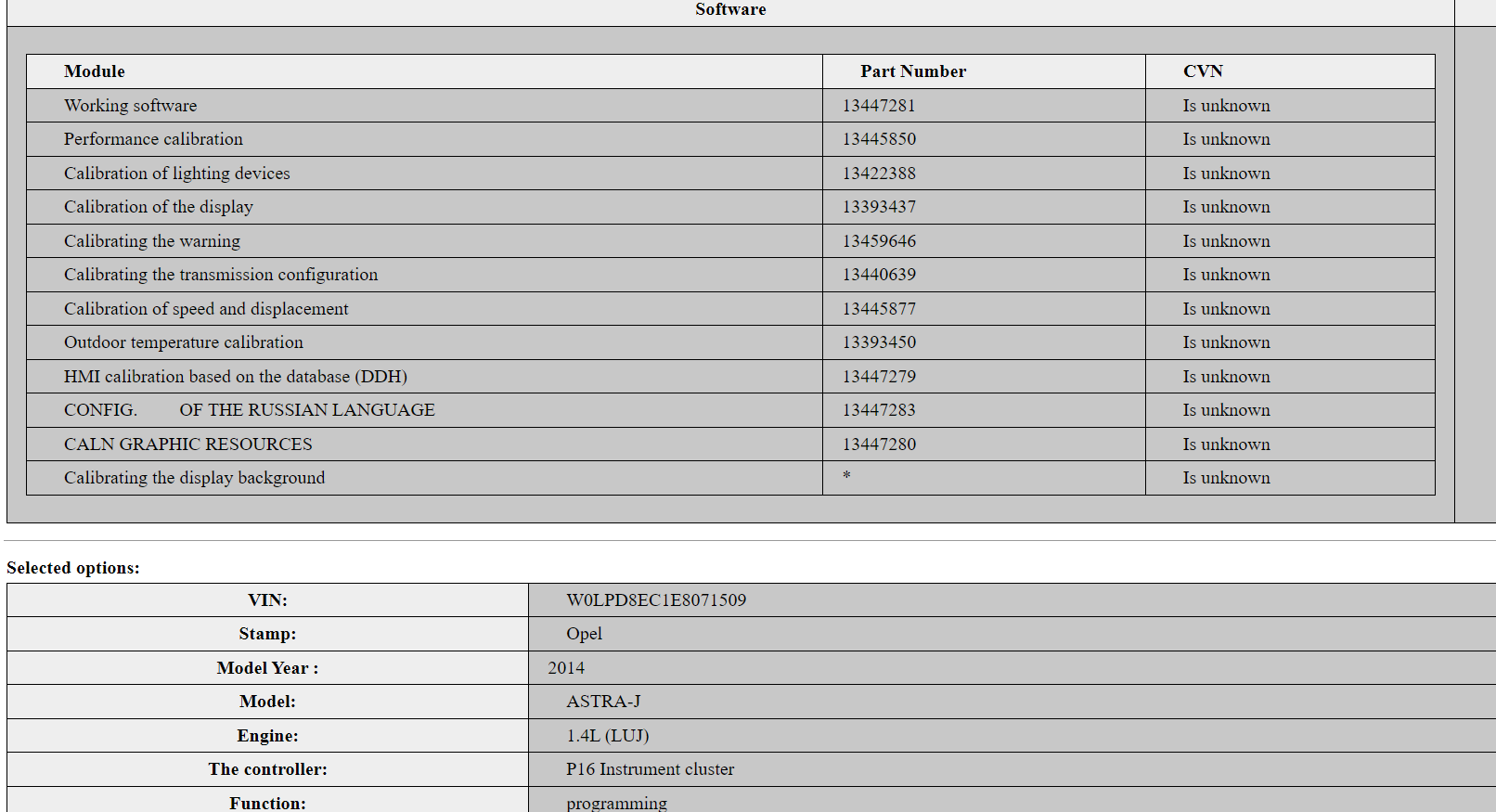

Hello everyone, in order to make UJM work on my dashboard, I downloaded the firmware from VIN W0LPD8EC1E8071509 into it. The car configurations match as much as possible, except that I have an electric handbrake, and that car had a mechanical one. Is it possible to enable the J71 option in the dashboard via the xmlfile? And if so, what lines do I need to add, I have several xml files from different panels, but unfortunately they don't have this option.

Problem is solved. I try to program calibration 4 13393430 from zafira c with electronic brake and lamp start work.
