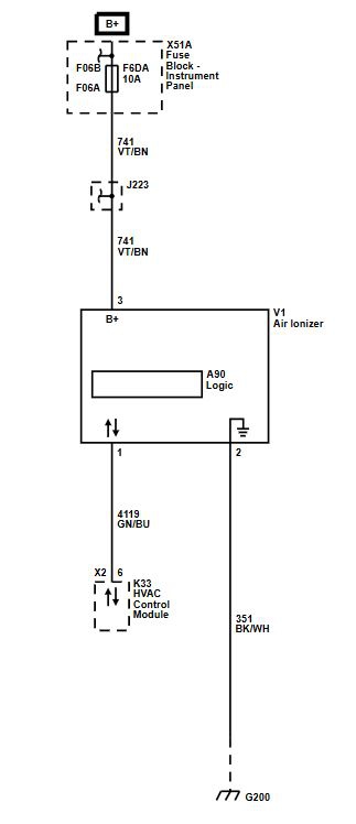

can someone send to me the Wiring Plan from the Ionizer Modul from the Buick Regal ?
I need the Connector and the ECC Modul where the Ionizer is connected.
Have many thanky for that

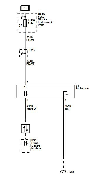

Or thw wiring from the cadillac xt6.
i see the xt6 have also the sensor.
Buic Encore 2021 also work and the best option vor me.

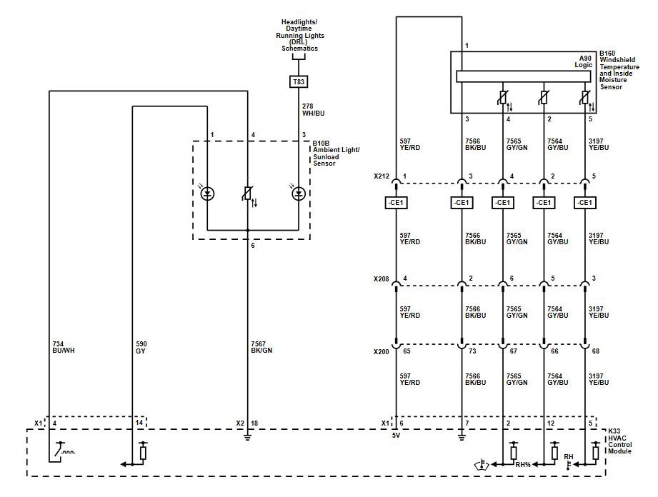

I only need the 3 connectors numbers on the ECC Modul
This is from 2021 Encore. Hope it is what you are looking for.
Hello, thanks i think that is the right one.
@ Galaxie
Could I request another plan? I also need the air quality sensor. I believe there are two of them installed.
I can only find one moisture sensor.
Hi, thanks strange. Hmmm or only newer cars have this sensor. Have you cadillac xt6 plans?
XT6 is the same
Ok thanks a lot for your help

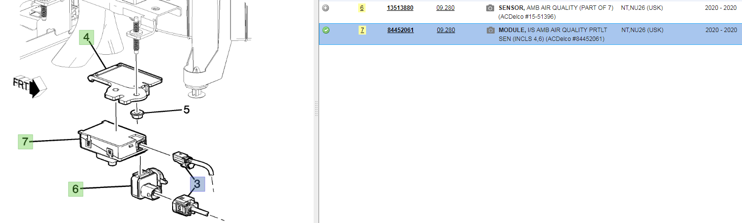

Aaah yes i see the sensor in ebay. For example:
OEM GM 2016-2023 Cadillac CT6 Chevrolet Malibu GMC Air Quality Sensor 84452061
Ok, finally found it. It seems it is not used on 2021 XT6, only on 2020 XT6. And only 1 sensor.

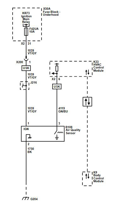

Oh nice but the same pin as the inoizer On the havac modul. Can you look on the xt6 2020 for the ionizer pin please.
Same pin, because they both are on same LIN bus line 4119
Thank you very much for your time and help.
Hi, i have look again at the cadillac xt6 the 2020 have a GM 84452061 Module Assembly, I/S Amb Air Quality Prtlt Sensor and a air quality sensor in the car. The cadillac xt 6 2021 have no sensor. Can you look again or look on the connector x1 or x2 from the havac modul for this sensor.
Thanks a lot.
Or the two Sensors parallel installed?
I can not find anything different than I already posted for sensor 84452061. However 2020 CT6 has a different sensor 13545810.
Hello, thanks
i diddn´t understand it
84452061 is the AMB Air Quality and have a connector and the 84452061 have a connector that the Module I/
Ah this is the he Particulate Matter Sensor PM2.5 is a laser sensor for automotive applications that can measure PM2.5 concentrations.
