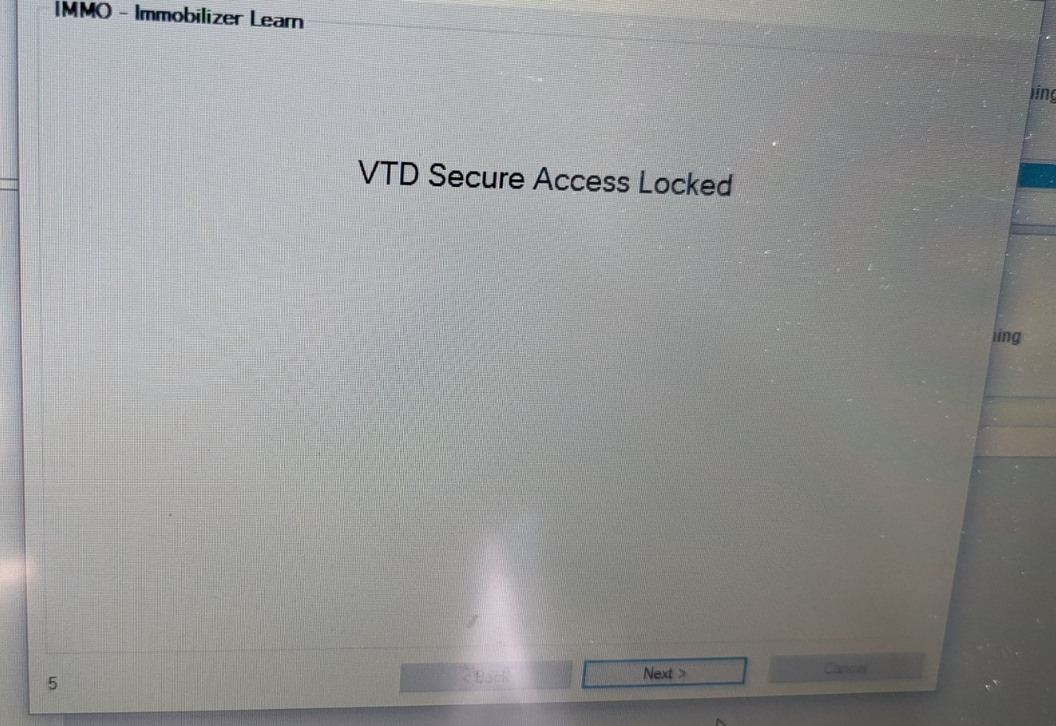

i have gmc 2024 sierra
I have a used ECM.
Is it possible to disable vats option to start car the same global A?
thanks
  • Replies 14
  • Views 757
  • Richard Beauchamp
    Richard Beauchamp
    Im currently doing the same thing. were you able to figure this out? I can help in other ways involving this.
    First check seed key, if all 00 00 00.. or FF FF FF.. - ECM soft bricked or modded
hi,
have you tried to reflash with TLC?
4 hours ago, blocked said:
hi,
yes in TLC
reflash in TLC changed OS calibration For the new VIN number
If VIN number changed - relearn immo
i try Immobilizer Relearn
gey msg
VTD Secure access locked
coz this ECM used and different pin number
also i try in
HPT disable vats
but not starting
in global A 2019 2020 2021 after HPT disable vats Vehicle starting
