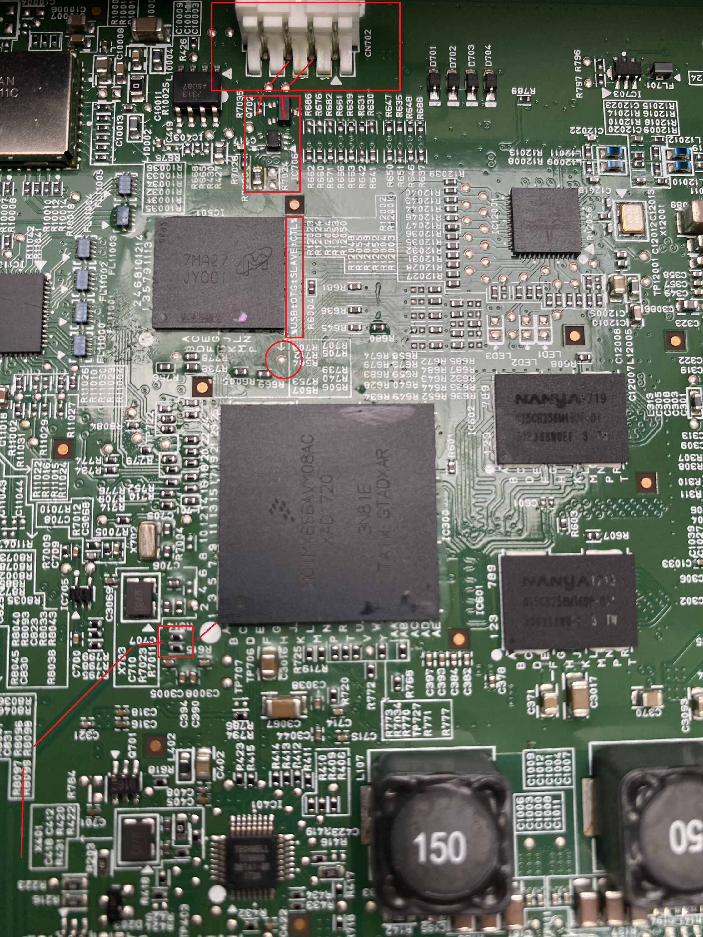

    managed usb ttl UART GND RX TX imx run UART4 port i use bruteforce on debug pins and finally find it

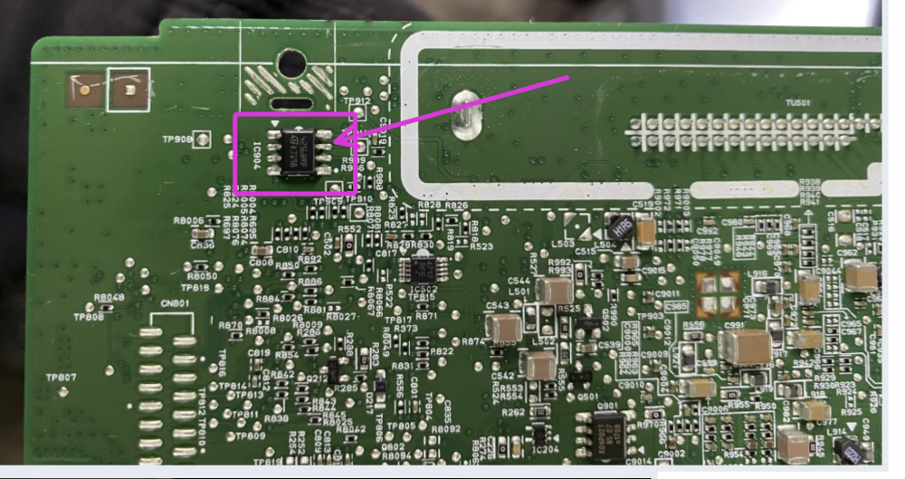

    I have installed my radio in my car and i dont took pictures from the uart Pins. But if your device is in bootloop the eeprom does not help. In this is the vin and i think the calibrations stored. The
Perfect wait to see the Bootlog.
