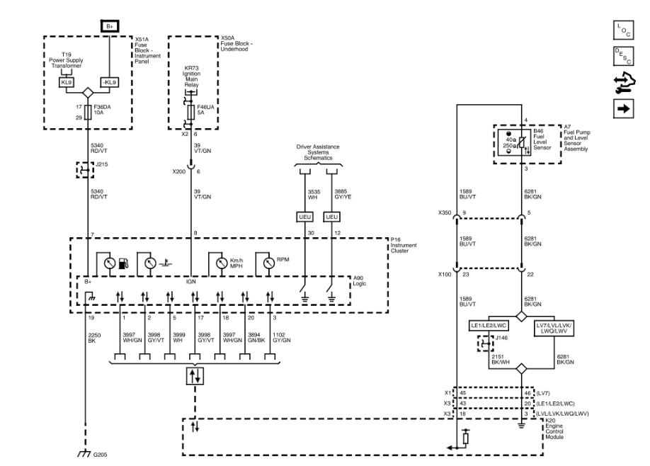

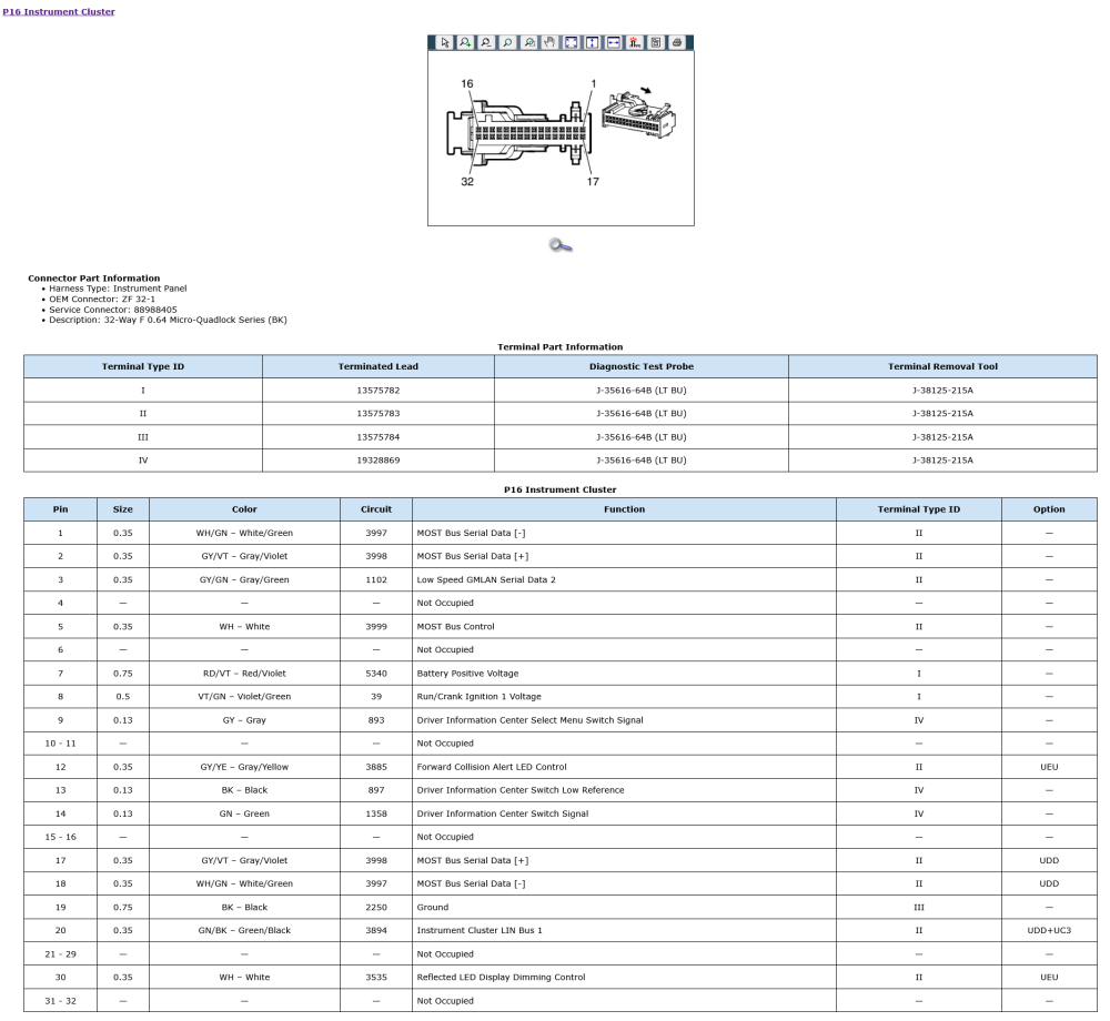

Can list the vehicle’s VIN and list the module’s description code? For example: The ECM/Engine Control Module is K20

Hello, because connect pin 3 of the speedometer with pin 1 of the OBD connector. This is the LS bus line.
