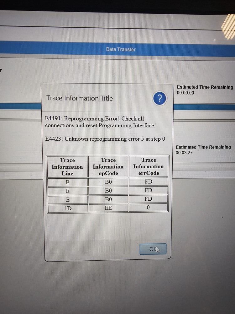

Troy, I did not get a DPS log since I was programming with SPS but here is the error message I get when trying to program side 2 of the module, side one programs fine. I spoke with Techline support and they won't help me since the vehicle is considered rebuilt but did mention wrong part or calibration. When I got the vehicle the keys were missing and I put in new keys and reprogrammed the immobilizer, it starts and drives but the dash is like a Christmas tree. Currently I put in a module from another 21 truck and it works fine, runs and drives no error lights but the keys have to be in the cup to start. I can't program the keyless entry module without updating the SDGM. Wonder if I should try using DPS to just change the VIN of the SDGM that is working that might allow me to program the rest.

It's hard to analyse the issue with the limited information provided by the SPS error response. OpCode B0 means Block Transfer To Ram, which may mean the SPS client is having problems writing the data to the module's memory. Normmaly the opCode 53, which means compare data is executed before the opCode B0, the SPS client will compare the data that's in the calibration file and whats already written to the module. If the calibration file code is incompatible with the code stored in the module, the SPS client will execute opCode EE, which means end with error.

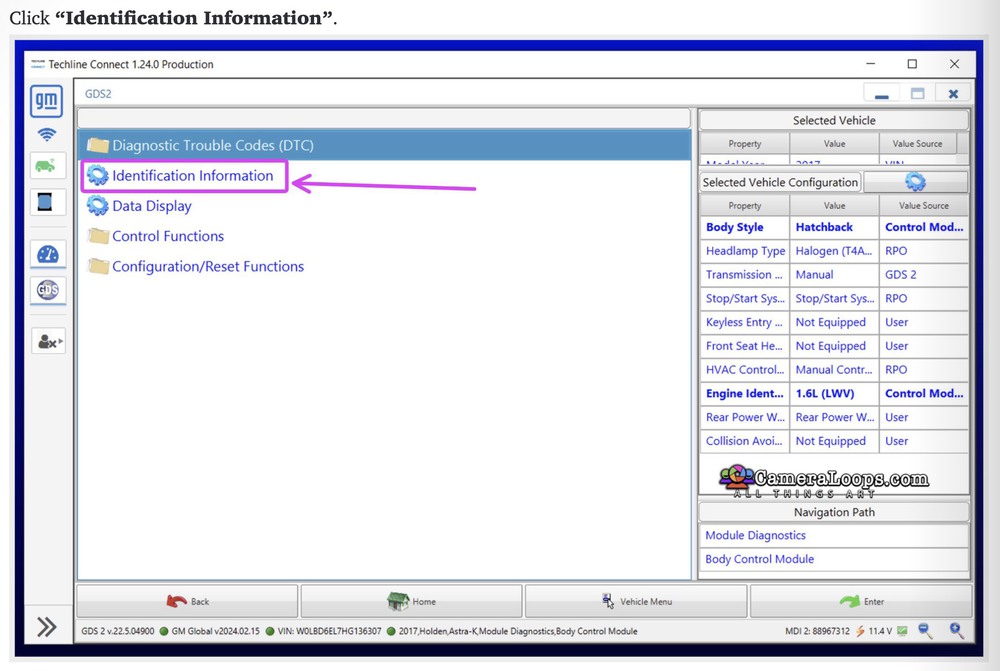

My best guess is that the used module you're trying to program wasn't taken from the same spec vehicle as the one you're repairing. You said you only have a 16 digit VIN for the module. You can try using GM GDS2 diagnostic software "Module Diagnostics" then "Identification Information" option, which should display the full 17 digit VIN, then input the VIN in this website https://www.vindecoderz.com/, which will inform you about the vehicle model and year the module was taken from.
GM GDS2 Identification Information

What device are you using? I'm going to take a guess but it's an MDI clone? If so, you're not going to be able to program it through SPS (looking at a utility right now that aligns with what you're showing). Either way, more information is needed.

100% that's your issue. The VCX has an issue with the buffer. Can you zip up your SPS Cache folder? If you have DPS I can build you a file that will program it. This is a common issue with clone devices. The only way otherwise to program it is to get a genuine MDI 2. You should include the log (it's under C:\Users\[username]\SPS and I can't remember which log it is there, might be in \SPSDebug) but I can almost bet you'll see repeated transmit calls and then it just errors out.

Yeah, there's a few you're going to hit with that. There's a few other posts that I've helped people with this same issue. They've defined different packet sizes in different utilities so some you'll encounter, some you won't. I have a VNCI and it has the same issue. My genuine MDI 2, no problems at all. You should be able to program most modules though.
