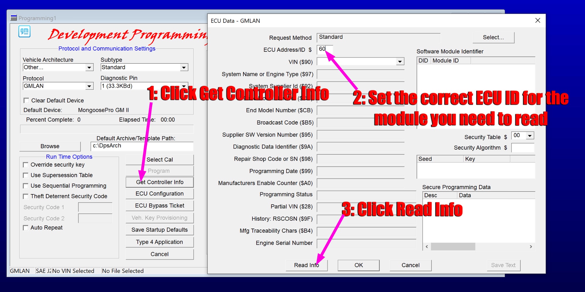

From the DPS logs. It states that the SDM VIN change file you purchased is not compatible with that SDM.
I can create the correct SDM VIN change file, but I will need you to provide me with the SDM calibration files.
Use the DPS "get controller info" option to read the VIN in that SDM, then use that VIN in the GM SPS service to get the correct calibration files and send the files to me via private message. The SDM DPS ECU ID for reading the VIN is:58
I refunded your payment for that file.
