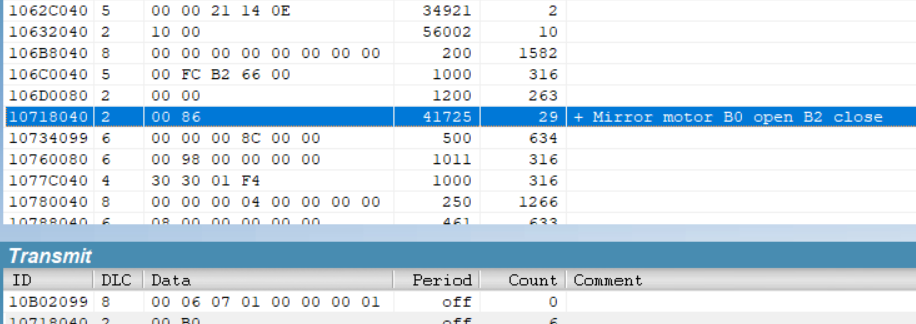

I found some GMLAN libraries, but I couldn't control them using the addresses specified in the libraries.
https://docs.google.com/spreadsheets/d/1qEwOXSr3bWoc2VUhpuIam236OOZxPc2hxpLUsV0xkn0
https://docs.google.com/spreadsheets/d/1pFdixF6W0XK4SR6pXHIlZaFRo9qM5XmAWOK7JcAQdDM

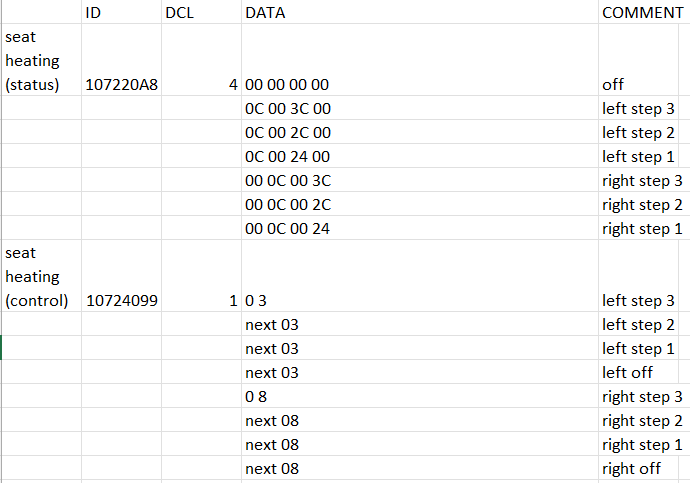

I found how to control the heating myself, found the statuses when the car is locked, but I couldn't open the car with commands. Who could have worked and who would share the tables?
For testing, I use OBDII pin 1 and pin 4 at a speed of 33.3kbps and software CANHacker 2.00.01 + ArduinoCAN.
